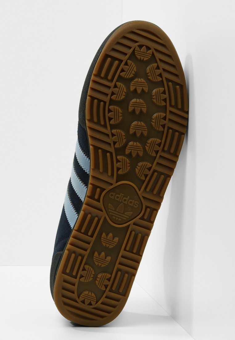

For mountain unicycling I prefer the fiveten stealth sole with Crank Brother Stamp 7 as the best combo, but for unicycle trials I’ve got the Reverse Escape pedal with Adidas Original Jeans
for the best result. The fivetens have too much grip in that combo and whenever losing my balance it could take a fraction longer before I can get my feet on the ground. Therefore these sneakers give a better result.
