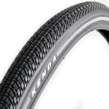

I FINALLY found and ordered a tire that I think is perfect. Close to perfect I was shooting for 1.9"
Kenda Kwick Roller Sport 26x2.0.
A step up from budget tires with 60TPI and up to 80 PSI for $21.95 and free shipping. They are rare as hen’s teets but I found one on Ebay.
https://bicycle.kendatire.com/en-us/find-a-tire/bicycle/commuter/kwick-roller-sport/
I was in a sports-centric big-box retailer yesterday and saw tires which may been identical to this. I knew I’d seen the tread pattern somewhere before - this discussion thread. Since Kenda is the king of cheap tire distribution, I’d think this tire wouldn’t be uncommon. Just look at what the sports-centric big-box stores have on the tire rack and you might find it.
What retailer?
I bought the one off Ebay and I’m really happy with it.
It’s called Dick’s Sports. They also have a faux-competitor storefront called Modell’s, which might have some of the same merchandise.
They have Dick’s where I live. I looked there and at REI when I was shopping. REI had a couple of candidates but they weren’t exactly what I was looking for. Dick’s, that I went to, had about 10 tires and none were 26" road tires.
In searching for this tire, I’ve found that almost all of the results are for an electric bicycle that the market is trying to get everyone to buy. So I guess it is pretty rare to find just the tire itself for sale. I agree with you that it looks like a good tread pattern so, hopefully it becomes more commonly available.
