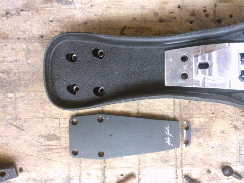

Is anyone running a touring bar? In order to use the stiffener plate you need to extend the holes at the seat and cut off some so that it fits the “shortened distance” between the grab handle holes and the seat base holes. Also, you have to flatten the bend in the plate, which is easy to do with a hammer and a blockof wood. I’ll post a pic of mine when I get a chance.

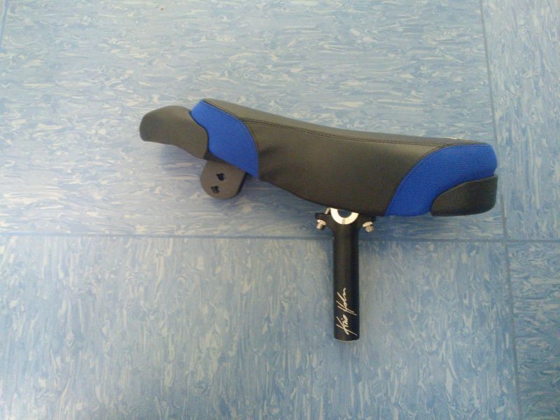

For my flattened freeride+touring bar i simply turned the plate around (upside down) drilled new holes into the plate, i think about 8mm more to the inside,( away from the post) and also shortened the plate by the same amount (at the post end).
Here’s a pic before drilling the new holes:
and here the finished seat:
Greetings

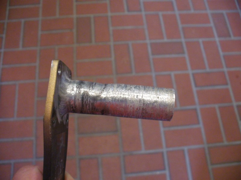

I’d love to get a Mk II version of the grab handle; my Mk I version is getting pretty worn from the fretting action of “just riding along.” Here’s a pic, though the “waist” where it’s worn isn’t so clear as in real life.

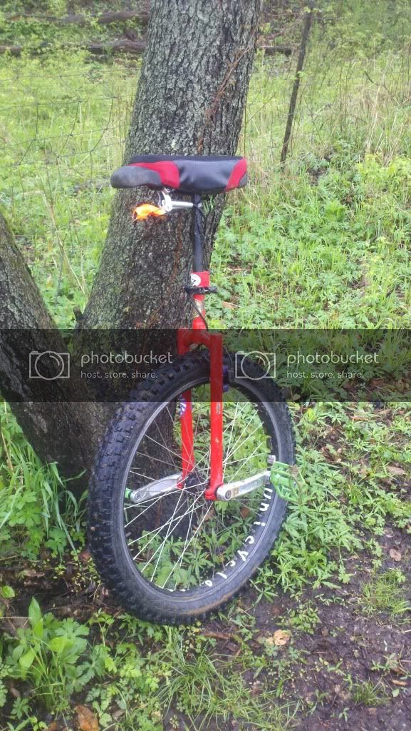

Can’t think you enough Ben! I took a picture of it on my KH29 leaning against a Disc Golf target in my back yard. As you can see, I have the KH adjustable seatpost adjusted a little more than slightly nose up for fear of sliding off the front. Now that I’ve ridden it a bit those fears are unwarranted. I’m considering adjusting the nose down a bit for my next ride.
Then I took it for a proper MUni ride at the newly opened Coppiced Woods trail. That asphalt you see in the background is the Louisville Loop custom made for a geared 36er. The second picture is about 1 mile into the 2 mile trail.
Handles great and far more comfortable than the stock (curved) Fusion Freeride saddle it replaced. What a game changer! I’m sure Kris and UDC will eventually mass produce a line of flat saddles but I’m glad I’m in on the ground floor!
