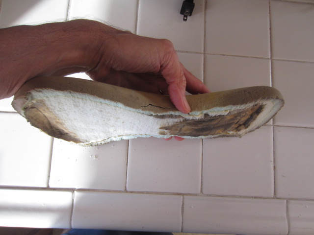

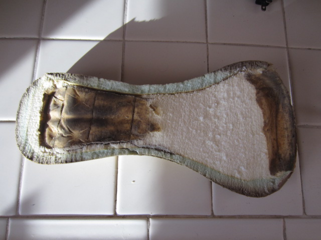

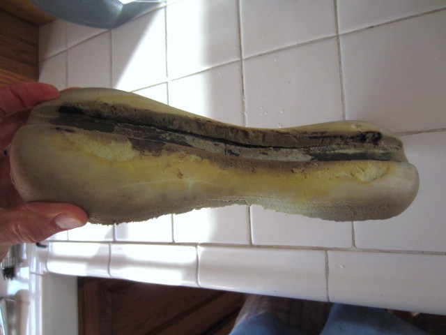

In anticipation of my base arriving soon, I cut down a spare FFR foam as per Ken L’s suggestion. Was surprisingly easy to cut, using a large serrated knife. Now I will have to either cut down a FFR cover and have it re-sewn or just order a KH street cover which should fit without any mods. The kh “Slim” was my first choice but UDC (US) doesn’t seem to carry it. The street should be close in size to the slim.
Man, that foam looks gross! Sometimes I’m glad I don’t live in sweaty SoCal.
Haha, it’s be covered so it won’t show! :slight_smile: It’s from a mod I did a few years ago where I used mesh to replace the vinyl top. This was before Kris came out with his mesh top. The discoloration is from the spray adhesive I had used to glue the material to the top of the foam and make the middle of the mesh top stay down in the channel. You can see in the previous pic that I had also enlarged the channel a bit. I ended up using velcro.
EEew, buttsweat :slight_smile:
Sure Terry, it’s the glue, there’s no way could that be from butt sweat :roll_eyes:
I went back to the old style vinyl KH seat cover because the mesh covers made my seat pads gross. I’m glad Kris is going back to vinyl.

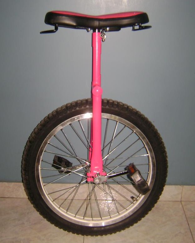

Here’s a strange looking uni (probably very low end, considering the cottered cranks and other cheap looking components) that also has what appears to be a pretty flat and thin saddle.

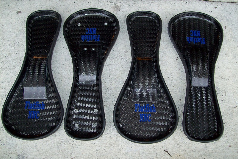

A school of Flatfish :smiley:
Which one is mine ?
The one on the far left :slight_smile:
