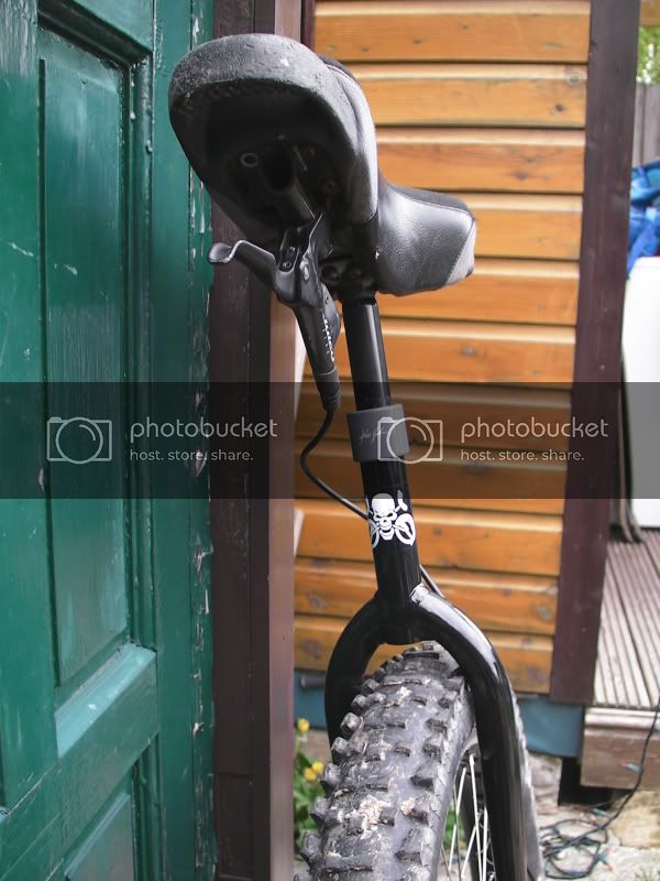

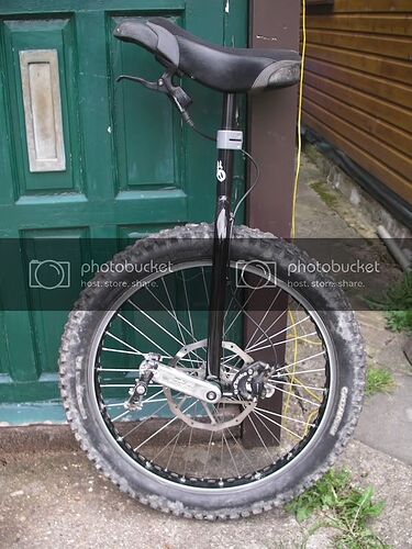

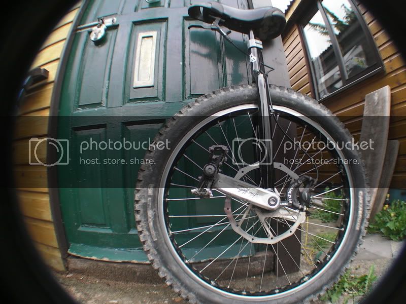

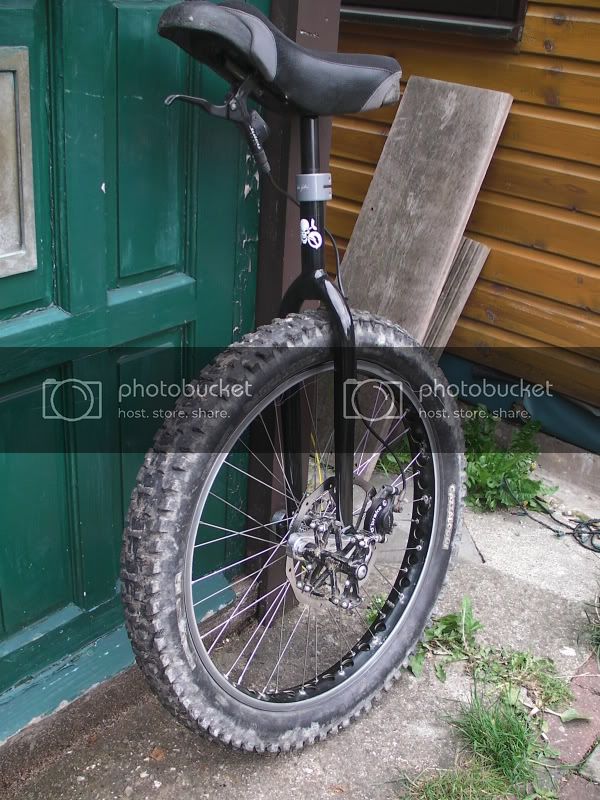

Got mine built up last night :slight_smile:
Tyre rubs on the frame because the rim is so badly buckled, it won’t true enough to stop it rubbing so I’ll have to get a new rim and relace the wheel.
The brake is so powerful, im going to be able to ride some stupidly steep stuff with it!
Its a monster, weighs a ton, but Im a downhill rider so it doesn’t matter too much :wink:
It does look very heavy- how do you get to the top of the hills you ride down?

If the rim wasn’t bent before you built the wheel, then the problem is with the build. Take it to your LBS and let them retension the wheel, the steep dishing on the Oracle hub is hard to true and keep true.
What frame is that?
Rim was buckled before I built it up. I was hoping I’d be able to true out the buckle but its too far gone. New rim time :frowning:
Its the Oracle frame :slight_smile:
Looks like a de-stickered Nimbus Oracle with those brazed on cable bosses and curved crown.
That Gazzi looks very tight in there :stuck_out_tongue:
Yeah its the Oracle, not sure why it came without stickers but Im glad it did. Not keen on the colour scheme of the Oracle.
Haha yeah it is tight, its actually touching in the photo because of the buckled rim :stuck_out_tongue:
You got a frame without the parts? That’s not fair! In the states we can only completes until the next shipment :frowning:
So, is the frame wide enough for a Gazz 3"?
Bummer about the rim, they aren’t cheap.
The frame is only 600g odd so not very heavy, is it not cost effective to order one from the UK?
Yeah the frame will fit the Gazz easily, my rim is just very buckled!
