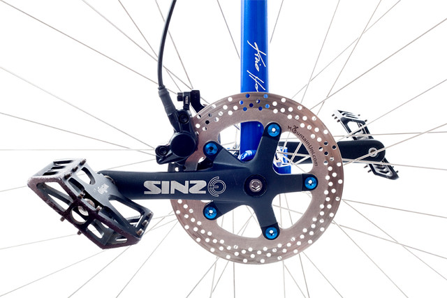

You could try the Mountain Uni UCM. It rotates the calliper up compared to the D’brake giving the unicycle a tidier look and prevents the hose from sticking out so far. But you have to remove the calliper from the mount every time you remove the bearing holder.

MountainUni is still around, selling disc brake kits, adapters, etc. I just bought one of their kits after deciding against going with a hub mounted disc setup.
MountainUni is still selling disc brake kits, adapters, etc. I just bought one of their kits after deciding against going with a hub mounted disc setup. Kb1jki posted that they are not moving forward at this time with their new design for custom cranks due to costs. That hardly means the company is done. I’m expecting the new KH disc cranks will work with the caliper mount as well.
MountainUni is still selling disc brake kits, adapters, etc. I bought one of their kits after seeing the Oracle and deciding against going with a hub mounted disc setup. Kb1jki posted that they are not moving forward at this time with their new design for custom cranks due to costs. That hardly means the company is done. I’m expecting the new KH disc cranks will work with the caliper mount as well.
