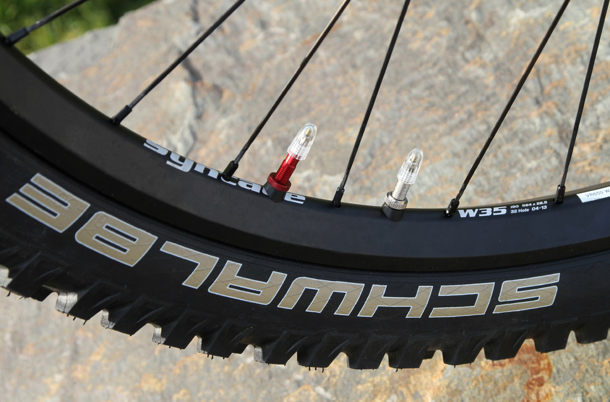

Dual Chamber Tire System
Schwalbe and Syntace made a really cool developement: a dual chamber tire system. Sounds interesting: “There is an additional air chamber inside the tire. This inner chamber is filled with high air pressure and effectively prevents the tire hitting the edge of the rim. At the same time, the inner system also secures the tire on the rim and prevents the dreaded “burping”, a loss of air of the tubeless system in the case of low pressure. Depending on the situation, the air pressure in the outer chamber can now be reduced to 1 bar (14psi) without running any risk.” This could really be an interesting option for Munis.
See this article for more Information.
Weight Penalty
Sounds cool but I’m guessing it will have a significant weight penalty.
They say +200g … but they don’t say in comparison to what…
What do you do if you tear the tyre too badly to run tubeless but not badly enough to bin it.
Also that inner tube is gonna cost a lot and the spacing between the dual valves is going to force a specific spoke count and possibly a proprietary rim.
