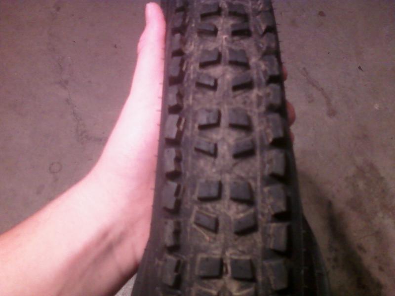

My first impressions of the Rubber Queen:
This tyre was cheap! At 40 NZ dollars.
Firstly before riding this tyre I noticed that it has quite a different type of rubber to all tyres I’ve felt (including a slow reezay 2.7 Highroller which I previously had on my muni). The rubber is harder than the maxxis tyres (ST and SR compounds) and it left my fingers felling kinda oily?
The version of the RQ I have is the cheaper wire beaded version without ‘Black Chilli’ rubber, it is lightweight at the clamed ~1050grams!
Custom Kris Holm 26’’ muni with RQ fitted:
When it came to mounting the tyre it was the easyiest tyre to mount out of a Highroller and Gazzaloddi which didn’t realy supprise me. It doesn’t have as tight a fit as those two do, which was nice for mounting.
The inner tube I have on there is a lightweightish one, a specialized 2.3-3.0 tube. I ran the tyre at about 25psi. So far I’ve only rode on this tyre for about 30 minutes.
The tyre seems to absorb bumps better than the 2.7 Highroller I had on previously, but it doesn’t seem to like going straight over roots, it seems to twist the unicycle to either side a bit. Where as with the high roller it was easier to ride in a straight line over roots. Grip is good although the dirt that I was testing it on was mostly dry. The RQ seems to have more rolling resistance but it still rolls pretty well. The RQ makes more noise with the ground and twigs than my high roller did. Also the tyre seems more bouncy than the HR.
After ~30 minutes of riding I measured the RQ with a caliper and the casing measured to 61mm (2.4’') mounted on a 47mm wide KH freeride rim at about 25psi. The casing width is wider than the tread width btw.
Tyre clearance:
One thing I find odd is that 3/4 of the tyre has criss cross reinforcing on the sidewalls and a 1/4 of the tyre on both sides at the same place does not. I’m guessing it has something to do with the writting on the rubber there.
You can see in this picture:
So far I like this tyre and it seems like a great tyre for $40 NZ. From very limited experiences on road and footpath at ~25psi it doesn’t go very well, which is important for me as a local riding desitination is about 1km away by road. I think it would perform better on the road at a higher psi, but I can’t be bothered pumping it up atm!
