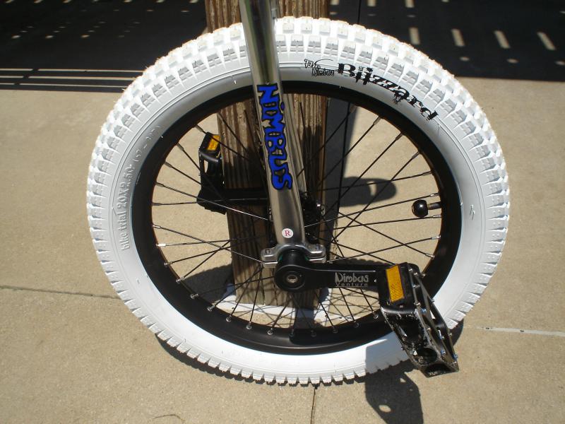

Nimbus Blizzard
Just got my new Nimbus Blizzard yesterday and just got done with my first real ride on it.
The only other trials tire I have ever ridden is the Creepy Crawler so that is all I can compare it to. It is mounted on a stock Nimbus Trials. Installation was fairly easy and done without tire levers.
My first impression is that white tires are awesome looking. The side walls are much thicker than the Creepy Crawler, giving me more of a controlled hop. (no folding over) One other notable characteristic is it has less rolling resistance than the CC and feels a little easier to turn. The tread pattern is very similar to the CC. The Blizzard is the same weight as the CC (according to UDC) and only costs $10 more. I would recommend the Blizzard even if you don’t need an indoor tire.

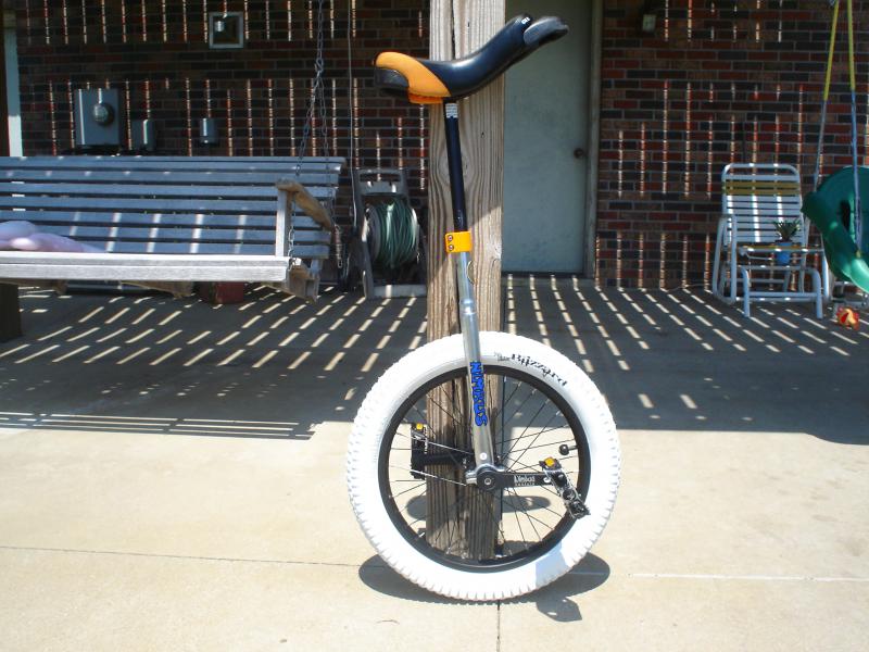

If there is enough interest I can post a few pics.
pics? yes please :slight_smile:
Pics
Found my camera. Now I wish I had a white clamp and seat. :sunglasses:
I too have that tire and love it for trials, Altho putting it on my KH 09 rim was a stragle and I hade to use tire levers to get it on… I love it for its bounce and rolling, it’s so much smoother then the CC
