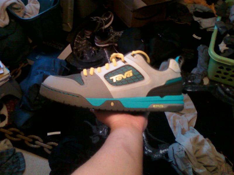

Just a few days ago I got my brand new Teva links. This shoe was designed by freeride mountain biker Jeff Lenosky in association with Teva. It is a very technical shoe with a lot of great features.
Features
Let’s start from the toe up. The area right above the toe is a standard vent area, with one exception, the vent has a rubberized mesh type of coatin that prevents ripping from pedals or what ever else you throw at it. The very front of the shoe is a hard rubber sole with tread that helps with climbing, and the toe box material almost feels lIke a rubber leather, it’s neat. Oh, and its all double/ triple stitched.
Getting closer to the middle of the shoe, the mid half is leather, synthetic I think. On the outside of the shoe, there is another vent that is rubberized. This is the one with the Teva logo on it. It seems pretty tough. The laces come in to colors, the neon/ bright yellow, and a gray the same as the outsole, they hard kind of stretchy too. On the tongue there are elastic bands to hold it down.
Getting to the back of the shoe, there are a few tech features. First, is the heel cup. On this shoe is one of the best heel cups I have had. The back of the shoe comes up to mid Achilles, and on the back of the shoe is the heel cup and stabilizer. The heel cuPis made of the same rubber as the outsold and the “stabilizer” is a solid piece of plastic. Down on the bottom of the shoe is the shock pad. It’s like the shock on bikes, without the bubble.
On the bottoms of the shoe is the spider rubber. I don’t have anything to compare this to, but ridin and hopping around a bit, I found this is very firm. As in it sticks to the pedal, but allows you to also move your foot around. On the heel is a reversed tread for walking downhill. It’s a very nice sole.
Oh, and it’s completely water proof down to the nano fiber
comfotabity
Honestly, this is the most comfortable shoe I own. The insole is Tevas mush liner. It’s extremely comfy. The only downside I have is almost no arch support. But the sole comes out, so you can put customs in.
Overall, I’m gonna give this a 10/10. Even though I haven’t had any other type mtb shoe, these rate high on me for what I had for skate shoes. IMO give them a try, the neon colors army too bad xD
