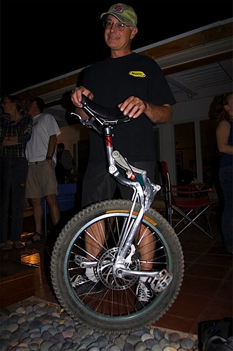

I actually did see a working suspension unicycle at last years MadFest outside of Madison, Wisconsin. I didn’t get a picture of it, does anyone else have one?
Essentially, it used the suspension ripped out of a fancy bicycle frame. It looked like a very wide >. Seat top left. Wheel Bottom Left. The right side was a hinge, and it was spring loaded in the middle. There was a rather complex chain drive that picked up the slack when the spring was compressed. It worked perfectly for Connie Cotter. I unfortunately was too heavy and bottomed out the suspension, which ruined the fun of it.
Sorry if the description wasn’t good enough. It is a very stable, but complex design.
