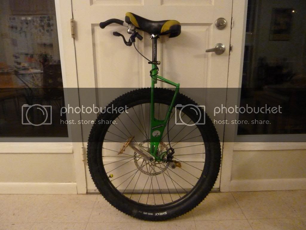

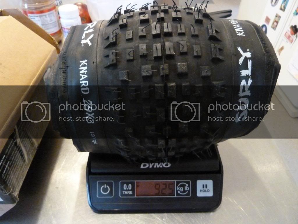

Some pics to tease your fancy:
Only ~5% (50gm) heavier than the Hans Dampf, but it’s 10% larger!!

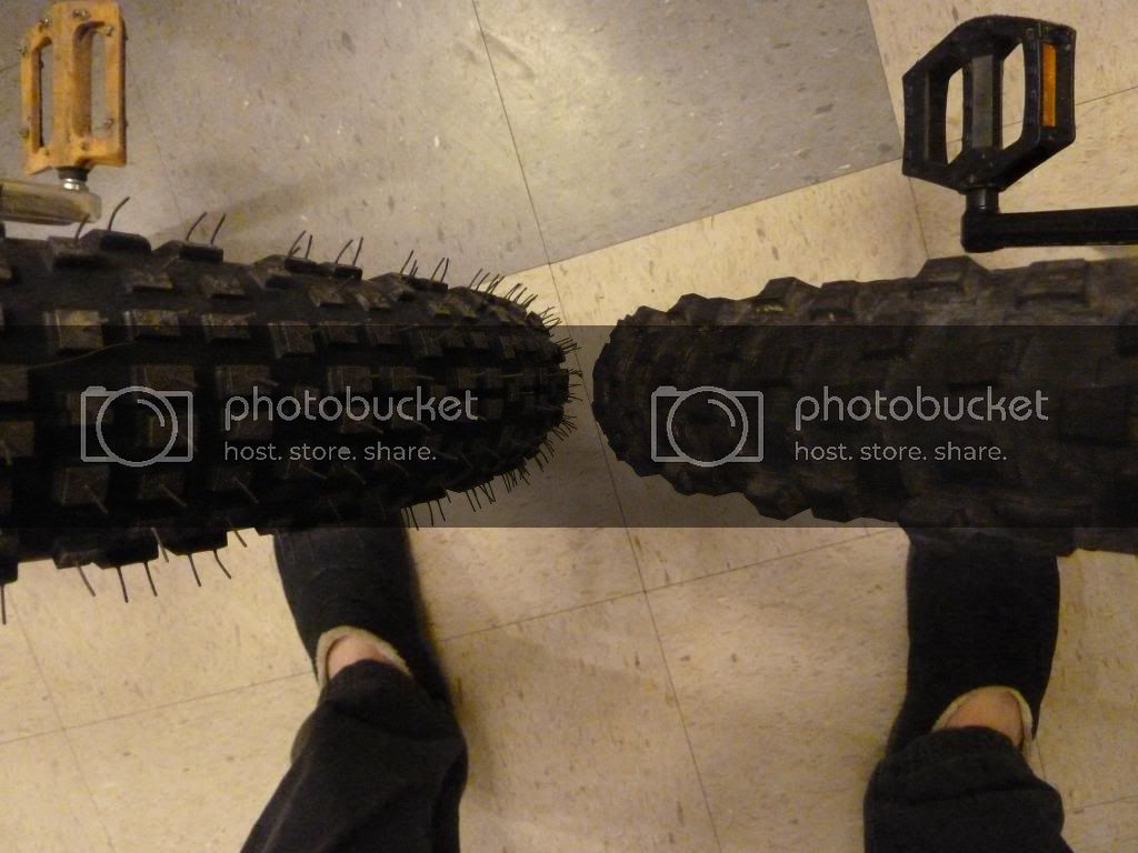

Doesn’t look so big until you compare it side by side with a Duro Wildlife 3" ![]()

Well, after some hard rides on varied terrain, Nurse Ben says:
One thumb up, one thumb down :o

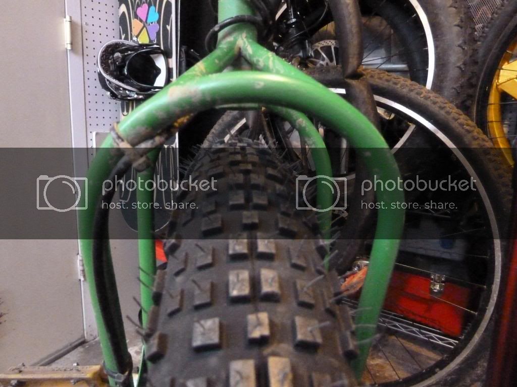

Based on this measurement, it looks like the Knard will clear the top of the KH29 crown by just 1/8" or so - thats cutting it pretty close. And I think you are using a narrower rim: I’m using the 47mm wide KH rim, so, hoping this additional width doesn’t use up any more of that remaining 1/8".
Thanks for measuring Ben.

I swapped back to my 36" wheel on my Triton today so took the opportunity to see how the Knard mounted on my KH Freeride rim fitted in my spare KH29 frame.
There have been a few photos floating round of someone who had done this before with a pre-production version of the Knard but unfortunately my 27tpi version did not fit in the frame with this setup. There is clearance on either side but the tire touches the top of the frame before you can tighten the bearing holders. Mine is inflated to about 20psi.
Is it close enough to fitting that you could put strips of beer can in your bearing holders to shim it?
Hi Aarons. You might be able to but it would take a few shims. The tire comes in contact before the bearings touch the frame and if you tightened the bearing holders the tire would be pushed down by 1-2mm. So even if you shimmed the frame up by 5mm you would only have 2-3mm clearance. I don’t know how much shimming people have done successfully in the past?.
This is just my experience though. You may get lucky and end up with a tire that does not stand so high with a different rim combo etc.

I think the main differential is that the frame in those photos was a 2007; since then the KH29 crown has been lowered. Even in the 2007 frame the clearance was paper thin.
I just looked at my measurements from the folding 120tpi Knard and it is significantly smaller than the wire bead 27tpi Knard.
Tread 74mm x 68mm
Casing 70mm x 64mm
@15psi
I suppose the stiffer sidewall makes the tire “stand up” more, but then the casing is also wider, and the above measurements are at a lower psi (15 vs 20).

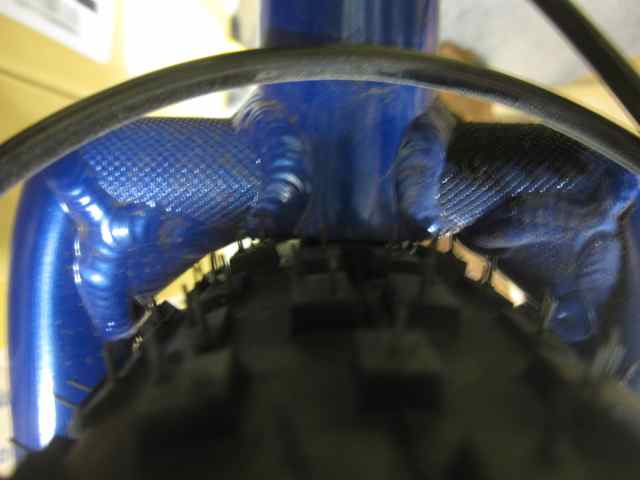

Bummer. I just came here to post this pic as you can see, I came to the same conclusion you did: The 127 TPI 29er Knard is not even close to fitting the second generation KH29er frame when on the 47mm freeride rim. . . . . Bummed, but I guess this means that if I have to have the Knard, I’ll just have to fabricate my own frame . . . or get a Triton frame. I also measured teh 2007 KH 29 frame I have here and it wouldn’t fit in there either.
Also, the tire width from sidewall to sidewall was approx 3 1/8" leaving just under 1/16" of side clearance between the tire and frame leg at 20 PSI.

So there are two production frames that fit this tire, the Oregon which requires a super wide hub, and the new Oracle 29" which should be updated to clear the Knard and is arriving in April.
The Oracle 29" frame is the same quality as a KH, less expensive, and includes a disc brake mount (D Brake), so it might be a good time to upgrade both your tire and your brake, but then there’s the hub thing…

Knard 120tpi, 970gm, $120 = lighter riders, cushy ride, more feel, squirmier
Knard 27tpi, 1270gm, $90 = heavier riders, soft ride, less feel, firmier
