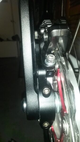

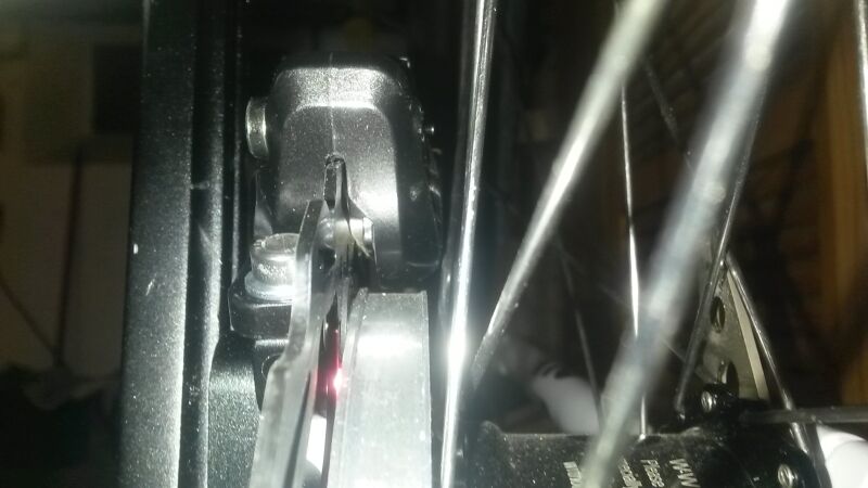

After rebuilding the brake screws to put the brake pipe to the vent screw and filing the brake body I have 1mm to the pedal and 1mm space to the spokes:
I seem to remember that I had to put a washer under the brake calliper of my hatchet as the edge of the disc was scuffing on the inside of the calliper making a ticking noise.
I hear noises like this when metal rubs against metal.
3 possible causes:
  1. Brake disc too high and rubbing against the brake. Remedy: Add a washer under the brake caliper to create more clearance. Or choose a combination that works. I’ve had this problem, for example, with cheap discs combined with Shimano.
  2. Screws for IS-PM adapter are too long and the ends rub against the brake disc. Remedy: Either shorten the screws or install a washer on the outside.
  3. IS-PM adapter rubs against the disc. This is usually just a fraction of a millimeter. If all else fails, carefully file the adapter down a bit or look for a different model.
These 3 things caused these noises for me. Definitely try aligning the brake again and only try the above steps if it really doesn’t help.
