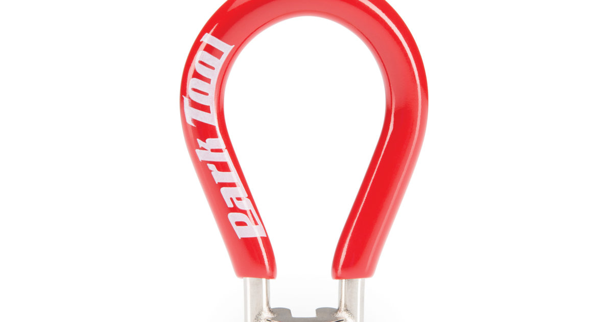

you don’t need to ever take the tire off, or event he uni off the wheel to tighten spokes. Get a spoke wrench
There are 3 different colours (make sure you get PARK!) and they are 3 different sizes. Take your uni to the store and have them fit the exact wrench, so you won’t strip them.
Pluck the spokes, and you are sure to find a few that are quite loose, this is why it’s squeaking (probably)
You can tighten really loose spokes without ruining the trueness of the wheel (true wheel has no warps)
If you are looking down at the spoke (the loose spoke is at the floor, uni is in riding position) counterclockwise tightens.
