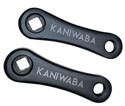

I thought I would start a topic to share parts for building nice and light builds with the good old faithful square taper unicycles, so here I start with a really cool crankset I found for electric bikes that doesn’t have a chainring and with a length of 89mm will be great for freestyle on an older unicycle!
https://www.kaniwaba.com/product-page/kaniwaba-cranks-89-mm-type-3
