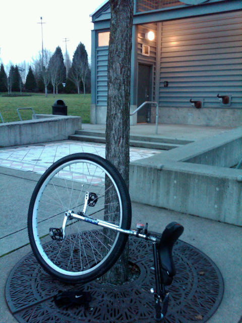

I’m still loving my Sinz dual hole (125mm/150mm) cranks. Of course, I’m really loving the Mountainuni brake rotor. It is working perfectly. I went down a massive hill earlier this week (wish I had taken video) and the brake made it possible.
Anyway, thanks to Jeff and Erik for the awesome job on the Mountainuni rotor, and the dual hole Sinz cranks!
This picture was right after I got the brake installed, and I had Forte clipless pedals in the 150 position. Now I usually use Odyssey twisted pc pedals in the 125 position…
