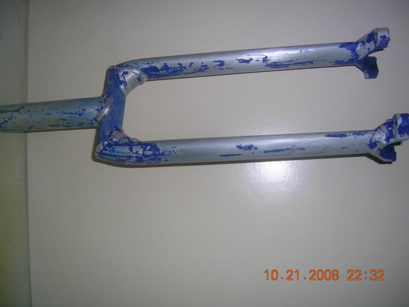

im striping my frame right now.. and i’ve been going for hours i think im doing it wrong i suck at this kinda stuff even tho i love it..
well i got this paint remover thing at some paint store, and they said it would work just fine, just kinda paint the remover on it and it will bubble and shell off and you can just pell it off..
i’ve done it.. 19 times now ! :smiley: and i have a kh and you know on the crown, and around that and over it just wont come all of… i will keep doing it.. i’ve wased it before a new layer of remover like 3 times, doesn’t really help a lot.. :confused: can anyone help me?
I used nitromorse paintstripper on my KH and it was realy hard going, didnt realy work. It took me ages and in the end I just used a grinder with a wire brush. I later thought, maybe it was too cold, I did it in my cold garrage. If its cold where you are doing it, move somewhere warmer or try hair drying it. It may help.
yea forgot to say.. the lady i bought it from said, let the metal rest inside for a night so it isn’t cold. because it was standing in our.. dont know what to call it.. but anyway! it’s not cold in my basement so i dont think that’s the problem.. most of the paint is gone now but there’s still some..
we do have a wire brush if it’s this:
but how will a sandpaper machine work? it’s not so hard on the metal and wont leave many marks? :thinking: or will i just use a box and get nowhere?
that’s how it is right now.. think im gonna keep it aluminium color.. or might paint it black or white..
Yea I used a wire wheel similar to theese… File:Staalbostels Roterend.JPG - Wikipedia
It takes the paint straight off and leaves a nice shiney brushed look. Gets all the paint out of the dips in the welds and the knurled parts quite nicely as well.
okay thanks for the tip i MIGHT try it, but i’ll try the same method again tomorrow, if that doesn’t work i will have to find the power tools..
im only afraid the crown will end up looking really ugly and that the grip things on it will be gone.. :thinking: :frowning:
