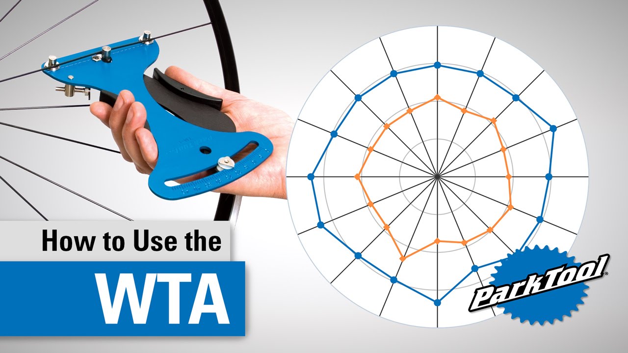

Anyway, here are couple of useful videos, the first is trials rider Ali Clarkson’s second part of his latest wheel building video (the first part is on wheel lacing). Ali builds a lot of wheels for folk, including (as far as I know) Danny MacAskill. The second is Park Tool’s video on using their app to document your wheel build.
I have a Park tension meter, however when you start to read about these things it doesn’t really stack up against ones from the likes of DT-Swiss and Sapim which are much more expensive. It is probably a case of diminishing returns though (and I suppose how much is riding on the quality of the wheel).
