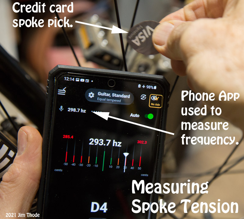

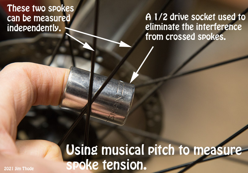

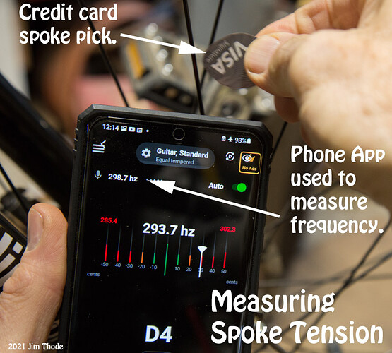

I’m tone deaf so I used an app on my phone to measure the tone for my 36" build. I also use a thing like a guitar steel at the spoke cross to get a true measurement on a single spoke with no interference from the adjacent crossed spoke. I’ve also used a small C clamp on the cross to do the same thing. Based on my measurement and calculation I’m putting about 90kg (200lb) of spoke tension on my 36er (brake side Nimbus) but I have no ideal what the rim is rated for. It must be about right because I’ve put several thousand miles on it with no problems.
