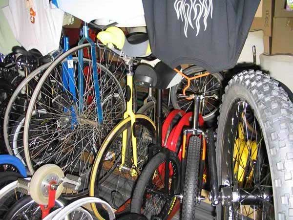

The yellow uni in the middle of this pic has a very skinny tire. I have no idea what size it is. It’s hanging in Darren’s shop. (I inverted the pic.) Any ideas?
The yellow uni in the middle of this pic has a very narrow tire. I have no idea what size it is. It’s hanging in Darren’s shop. (I inverted the pic.) Any ideas?

Wow, that’s a beauty. It will say on the side of the tyre if you’re really interested. It’ll say something like 700c x 28, or 700c x 32. (Or an imperial (inches) size like 27 x 1 1/4 .
At a guess, I’d say it’s probably around 28 mm, same as mine. Coul dbe a touch narrower. Nice looking machine. :sunglasses:
