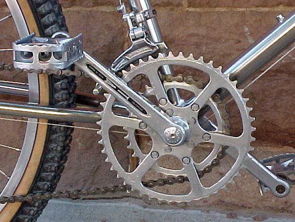

I’ve used some 20 year old BMX pedals like this:
They have good grip, and are very light.
