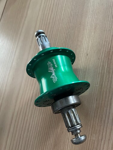

I’m selling my Mad4One FlickFlock hub for €350 (or best offer).
It works well in both freewheel and fixed wheel mode.
Why the reduced price:
I had to replace one of the M4 parts that connects to the mode-switch button. I accidentally used a crank removal tool incorrectly, which bent the M4. To fix it, I had to open the hub, and once the hub is opened the warranty is void. The replacement was carried out by an experienced and skilled bicycle mechanic in Norway, using guidance provided by Marco Vitale at Mad4One. The result was excellent.
The reason I didn’t send the hub to Italy for service is simply the high shipping costs, since Norway is outside the EU.
Why I’m selling:
I really enjoy freewheel riding and have barely used the fixed wheel mode. For that reason, I’ve switched to a dedicated freewheel hub. I hope someone else will enjoy the versatility this hub offers.
Notes:
On rare occasions (about 0–5 times during a one-hour freewheel ride), there is an extra clicking sound from the hub. It feels like it skips one click before the pedals engage. This doesn’t affect functionality, but can be a little annoying. It can most likely be fixed with some adjustments.
I visited the Mad4One factory in Italy in June this summer, where Marco Vitale inspected the hub and found no issues. At that time, only one new FlickFlock was still in stock, so this could become a sought-after product.

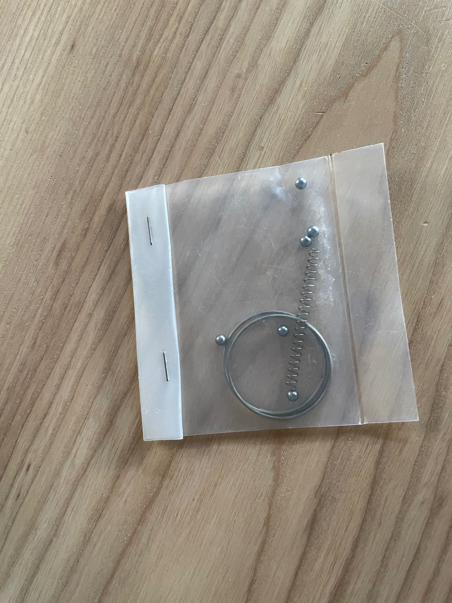

The sale also includes the only spare parts currently available for the Mad4One FlickFlock: balls and springs. (See picture.)

@Wheelou you wont regret it, bargain price. The extra click is common to all the flick flock hubs and only happens occasionally. Rode mine 3 years and no real issues, but it did ratchet on one notch from time to time.
Best tip, buy a crank removal tool from M4O that has a magnetic reversable head, a std crank removal tool wont work and will bend the mechanism. If you ever need to change bearings, rotor, you will need one. :grinning_face::+1:
