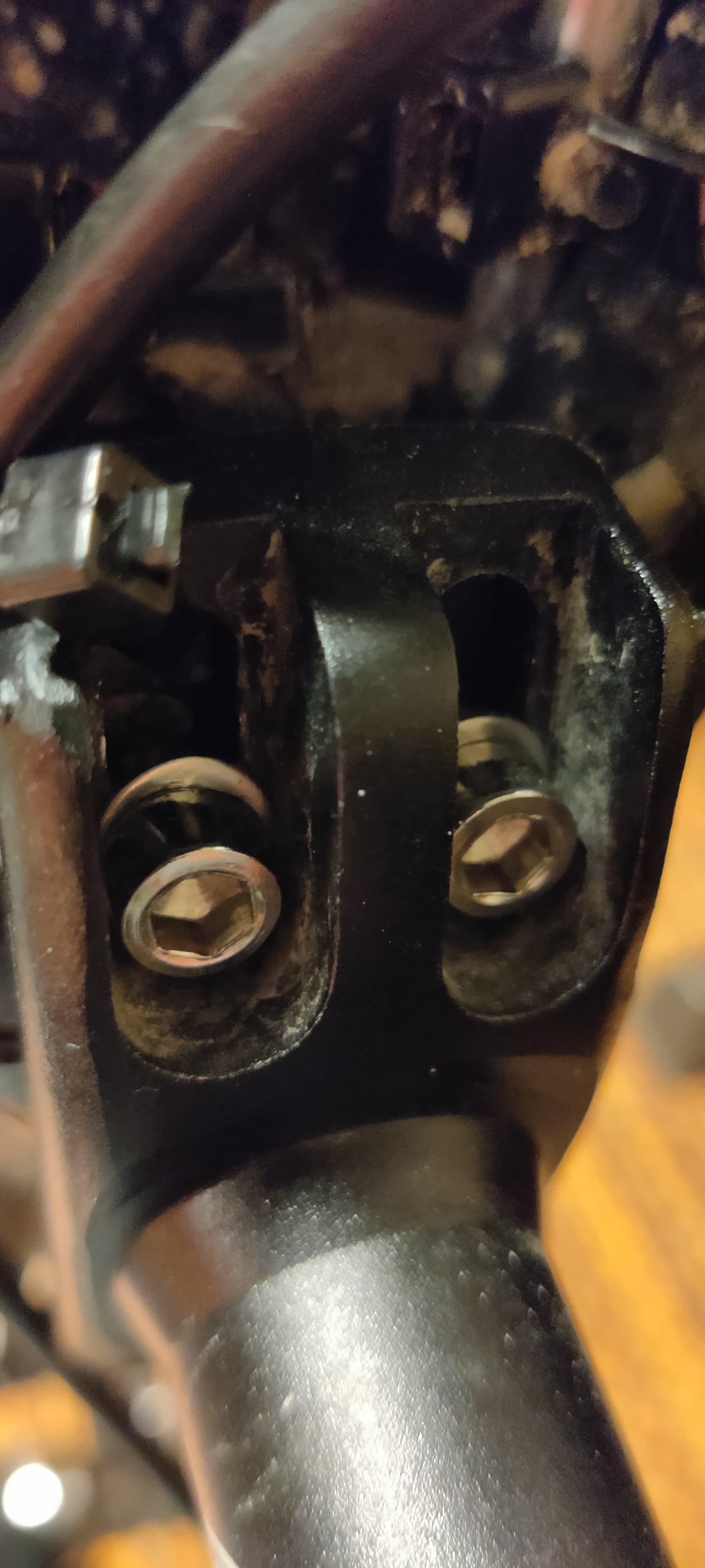

A little closeup if you are curious
Also of the funny oval washers
I believe you get both nuts and washers with seatpost and m4o handle saddle (That’s why I have a few spares)
Awesome. Thank you. So, in your picture you aren’t using the socket head cap nuts, right? Your seat looks like my original M4O seat that they assembled, and now it looks like the one I’m putting together as well. Just the regular hardware is used.
My picture is of a m4o XXL seatpost and a m4o handle saddle using the hardware delivered with them.
I’m not using the flat head cap nuts that is used with other regular saddles. They will not fit
Hmm a standard nut taken from a KH free ride seems to fit without issues. The washer (not in picture) does not fit. It has to be oval
Yep, I follow. I installed the XXL seatpost on the saddle and all is good :heart_eyes:
