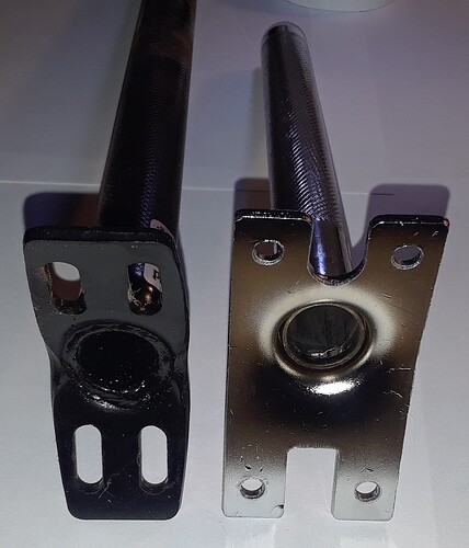

- Is your seat post the correct height? You don’t want to go for a really long ride with your saddle too low. If you can’t raise your saddle high enough because the post is too short, measure it with some vernier calipers if you have them. Unicycle.com should have some longer posts you can get.
- If you do need to get a longer seat post, double check the bolt pattern for the saddle on the unicycle. Does the bolt pattern look like the left or right post?
If the saddle mount looks like the one on the right, then you may need a new saddle as well (which bolts into the pattern on the left). I don’t have any specific recommendations for which saddle to get, but I’ll add it might be beneficial to buy a long saddle handle that could provide some upper-body support.
