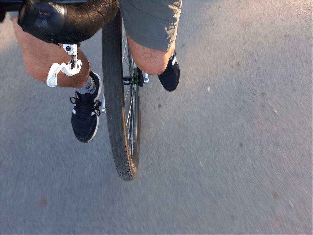

So I swapped the QU-AX 145s on my 36er with the KH 150/125 Moments from my 29er and had a great 18k ride this morning.
Freemounting initially felt harder but soon I realised that all of my concerns about shorter cranks (going too fast, loss of control etc) were in my head and quite easily overcome, so I look forward to riding on them some more later this week.
One big thing I did notice straight away was just how much smoother the whole ride was. I wouldn’t have believed such a difference was possible but it really is! So I’ll stick at 125s for now and maybe in a few months I’ll give some shorter cranks a go.
