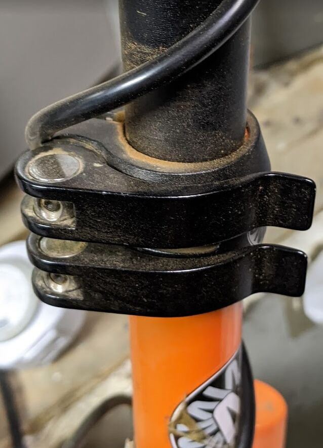

I’m having some trouble with slip (rotation) of the seat post on a Nimbus Muni. Those clamps are really tight now, but it still slips. I don’t think I can get them any tighter. I’ve taken the post out and tried to clean it (haven’t tried any solvents yet), but that didn’t help. There’s plenty of post in the top tube, probably 4 inches. Maybe I should try cleaning with something fairly mild like rubbing alcohol? Any other suggestions? My other unicycles don’t have this issue - only this one gives me trouble.
(that’s not rust around the top - it’s Sierra dust from the last ride.)

Lubricate the QR? If the cam of the clamping mechanism is dry, you will get much less clamping force for a given hand force. Obviously take care not to get any grease on the seatpost, but the QR cam shouldn’t be completely dry and it looks like it might be in the photo?

@jswim788, this should be your first port of call. Just stick a bit of oil or grease on the plastic section, rotating cam part ,and the silver centre sections - you’ll likely find that you can get it much tighter that way.
You shouldn’t have issues with the post slipping even if you greased the post up before putting it in though. I had one for years and once I’d discovered the wonders of a bit of lubrication I never had any issues even with hard riding with bars and some hard falls.
Agreed. The one I’m using is the same as the one pictured above (i.e., Nimbus with two levers). Perhaps the cams could be designed differently to create more leverage?
