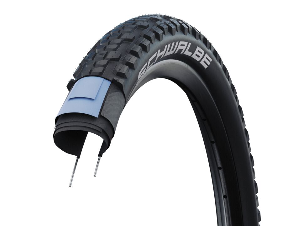

Schwalbe has a new 27.5" fat tire, or at least I just noticed it. The SUV tire Johnny Watts is apparently also available in 27.5x 4.0. Certainly not a typical MUni tire, but probably a very puncture-proof, durable all-rounder. Has anyone ridden it?

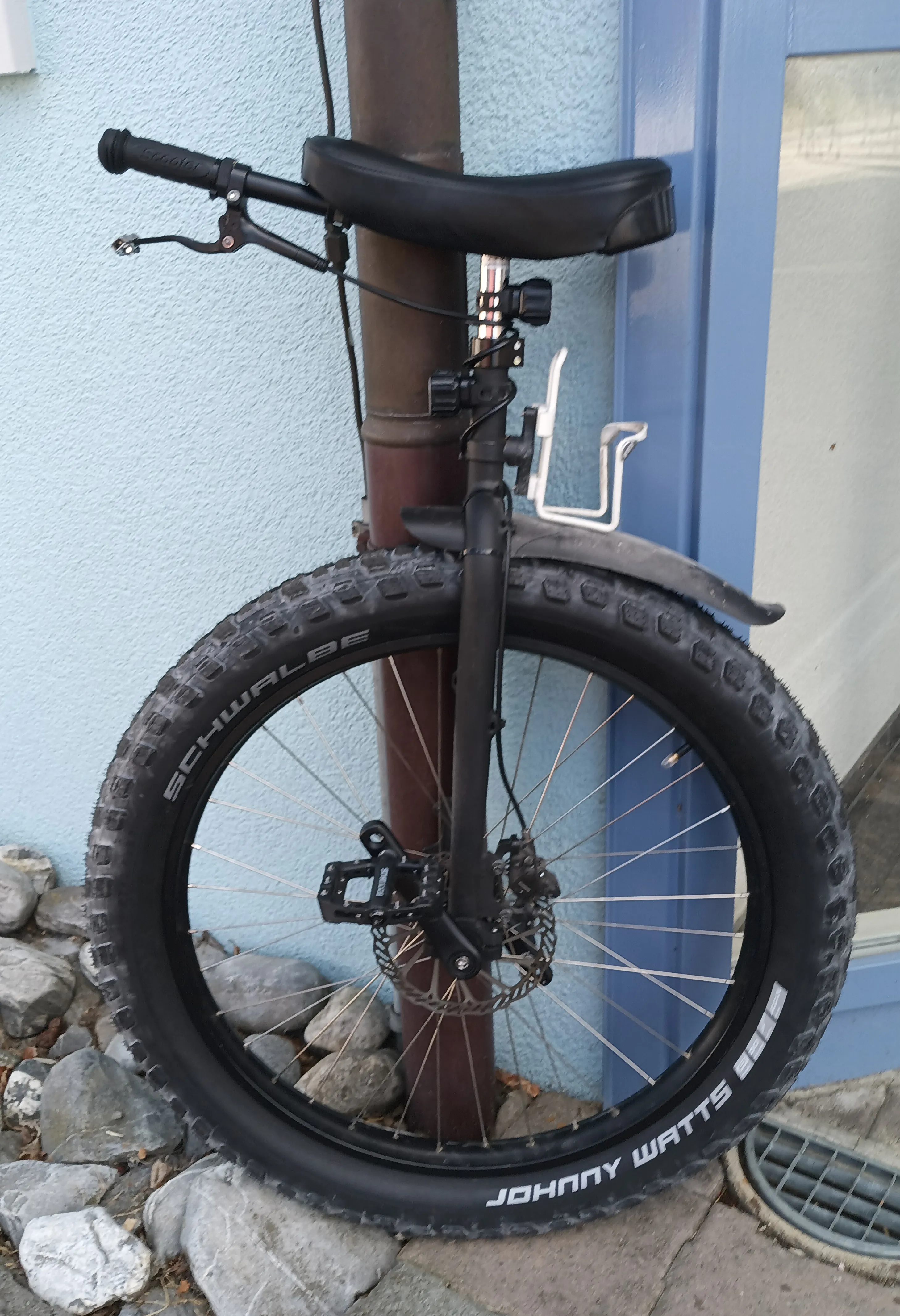

Now curiosity has gotten the better of me, and I’ve ordered the Johnny Watts 27.5x4.0.
I’ve only ridden around the warehouse a few times with different tire pressures and can already give my initial opinion.

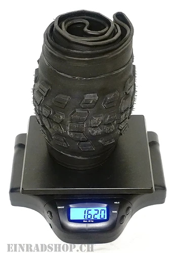

The tire is a pleasant surprise. Although it’s quite heavy at 1620g, it’s easy to handle. I’m riding it with the 26" Fatty tube (hopefully it will work with that), so the minimum air pressure is always relative to the TPU.
I’ve found the lower air pressure limit to be around 0.6 bar (topeak manometer, the schwalbe shows 0.72) with a 45mm wide rim, i=39. With a 65 or 80mm rim, it should be around 0.4.
The tire already runs quietly and smoothly and steers relatively well. Self-steering is limited, so far, nothing negative has been noticed. I’ll write more about that later. I’ll ride it on the Fatty for a few weeks.

- Weight: 1620g (1610g manufacturer’s specification)
