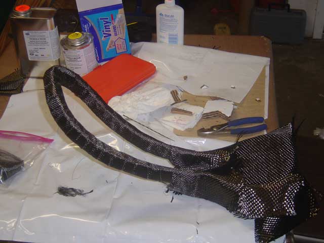

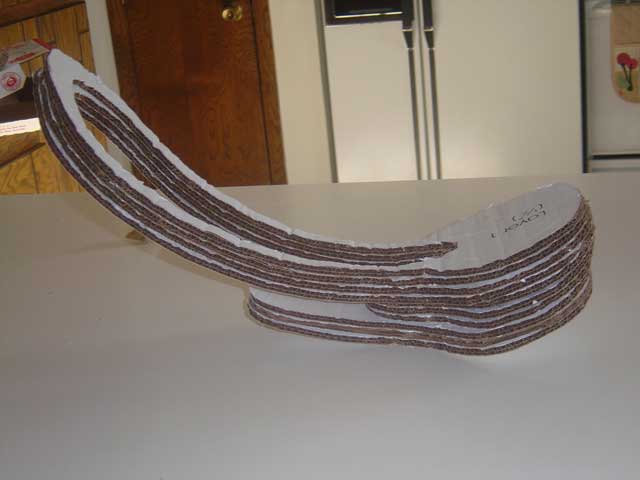

Here are some pics from May when I was building it, though I never took any final pics of it.
This is the core made of cardboard before I laid the composite over it:
This one is part way in the layup process and shows some of the shape:

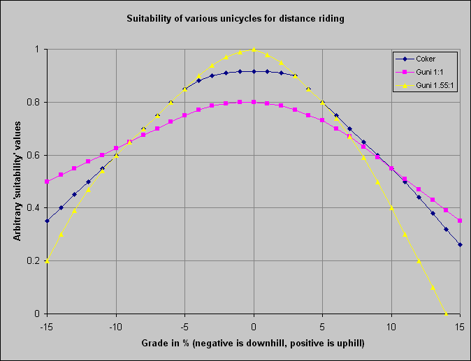

I’ve fiddled around with Excel a bit and produced the attached graph that shows exactly that: it is a continuum. This is based on your earlier numbers.
But I would need LONG roads that have various grades, and I don’t have those here. Every climb is short, except the ones of 0 %.

Cool, thanks Klaas!
I think that sums it up very nicely indeed.
Hmmm…got me thinking. I wonder what would happen to those curves with shorter cranks (say 110mm?). I would guess that it will steepen both the Schlumph 1:1 and 1:1.55 curves, but there will be a greater difference between the two at either end- essentially a wider gear differential (ie it would steepen the 1:1.55 more than the 1:1).
