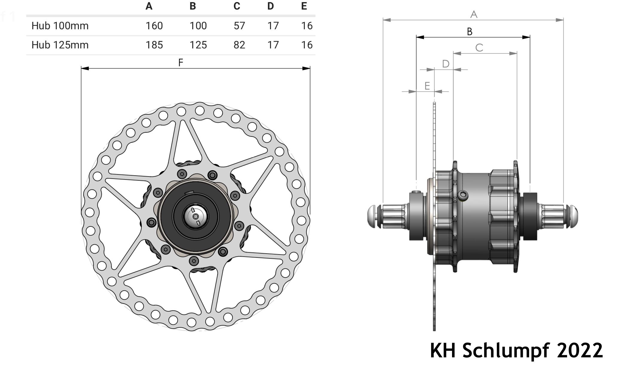

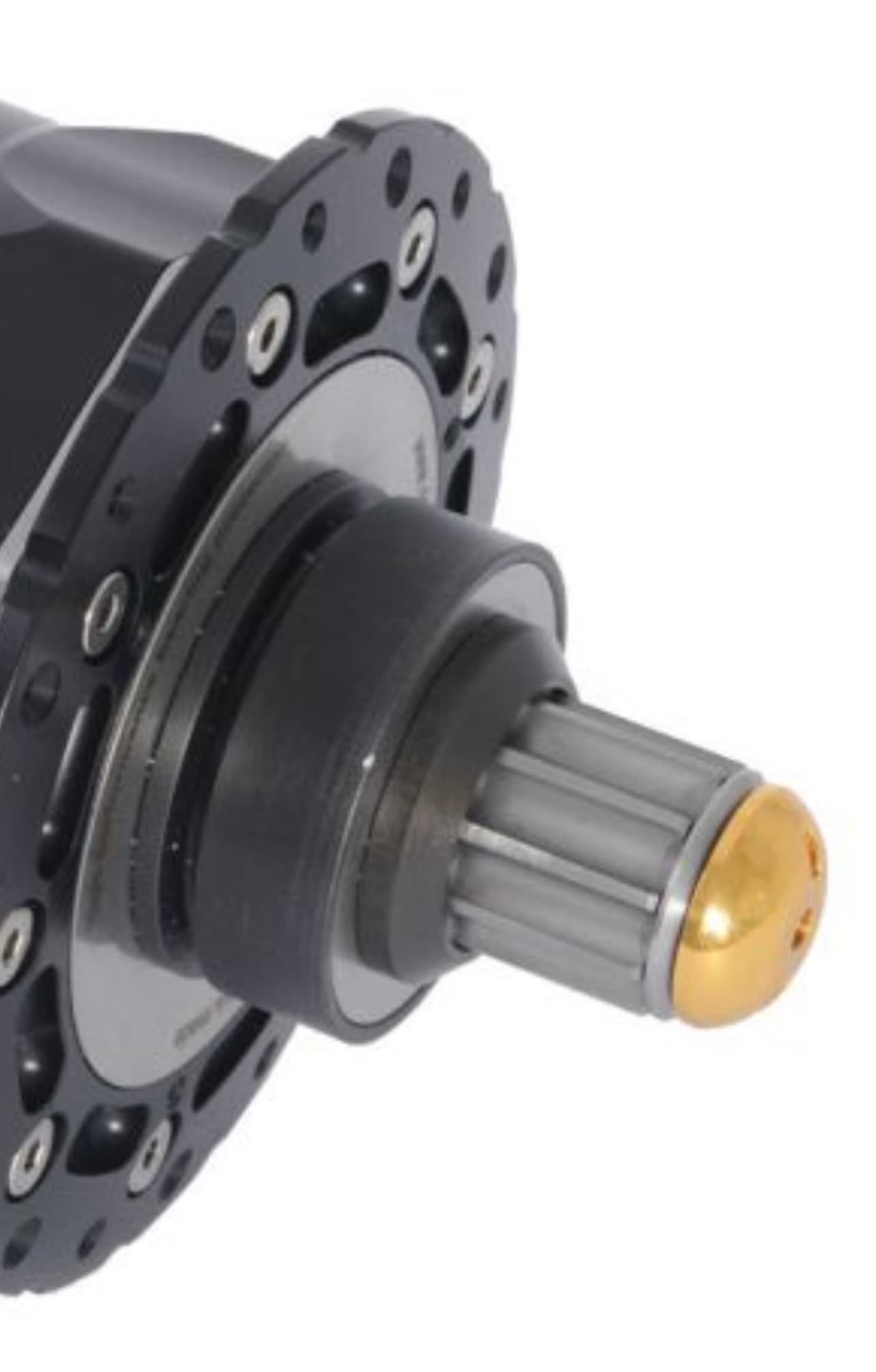

I’m going to take it that the new versions will still come with these that slot on the axle ends - I suspect the CAD drawing doesn’t include this as it is an add on

I suspect there’ll be no way to lock the freewheel.
The only access the CAD drawings show is via complete disassembly, or the grease/oil port so I’m not sure how you’d possibly do such a thing.

Just heard back that the 190mm should be detailed as 180mm rotor and the crank stops are unchanged from previous version!

Thanks to @Hammer for the nudge on this one - put this together to make it easier when reviewing hub specs.
