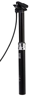

I’m looking for an adapter I can use with a dropper post
so I can use a KH type saddle to support me on kneewalker .( I am disabled )
The an idea of my design ( here ) would have the dropper as the extended bit on the right so I can have saddle remotely rise under me ( the saddle would on the right angled section above it ) and my knee on the lower pad support to the left where it usually resides.
The only problem is I cant find a dropper post without rail clamp so any idea on what I could do to get round this would be welcomed.

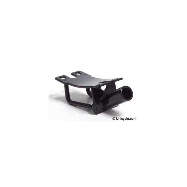

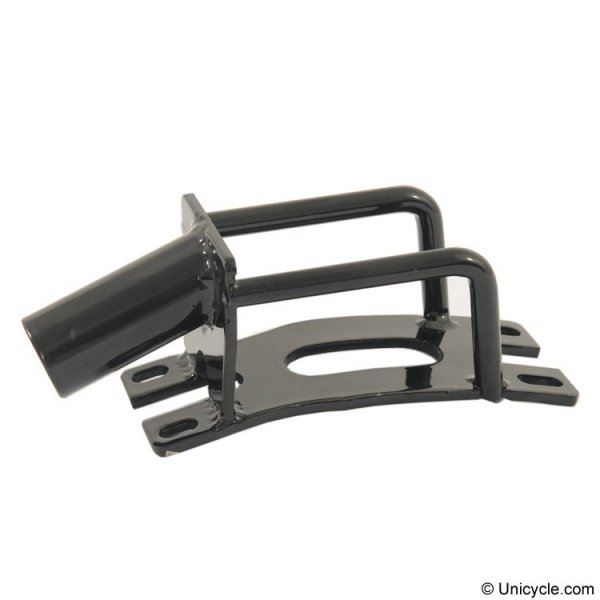

Hi Segaki,
you will just need a Kris Holm rail adapter (seems still available in the German unicycle shop).
You may be able to find somebody with an old KH (around 2004-2007) that don’t use it after swapping their adjustable seatpost for a regular one (or the more recent version of the adjustable).
I cannot visualize the whole thing you describe, but I hope pics will soon come to help :wink:
Note: the attached pics are from the municycle.com website.

You can’t really use a dropper post on a uni (I can’t). When you drop it down, you can pull up on it, so you wouldn’t be able to hop with a low seat. Let us know if you try it! I thought about it, but that issue is stoping me.
