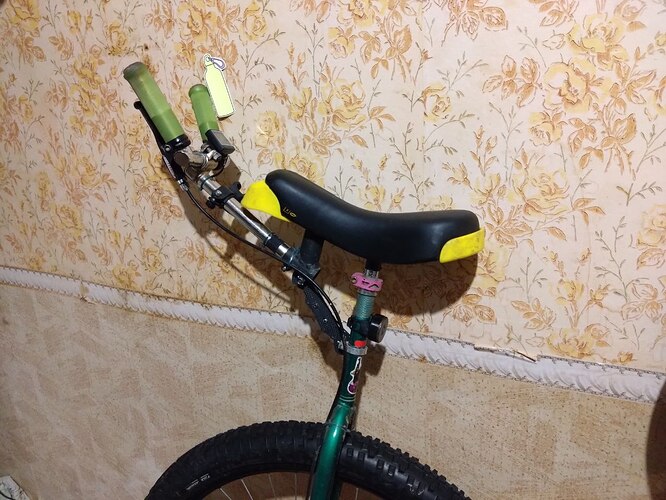

On my current setup I have un-curved QU-AX Luxus saddle with modified foam. I made it a bit better, but still pretty uncomfortable. And custom handlebars out of cutted BMX handlebar and some handmade parts. Important notice: I attached it to the frame, and it made the construction pretty stiff. I like how it feels.

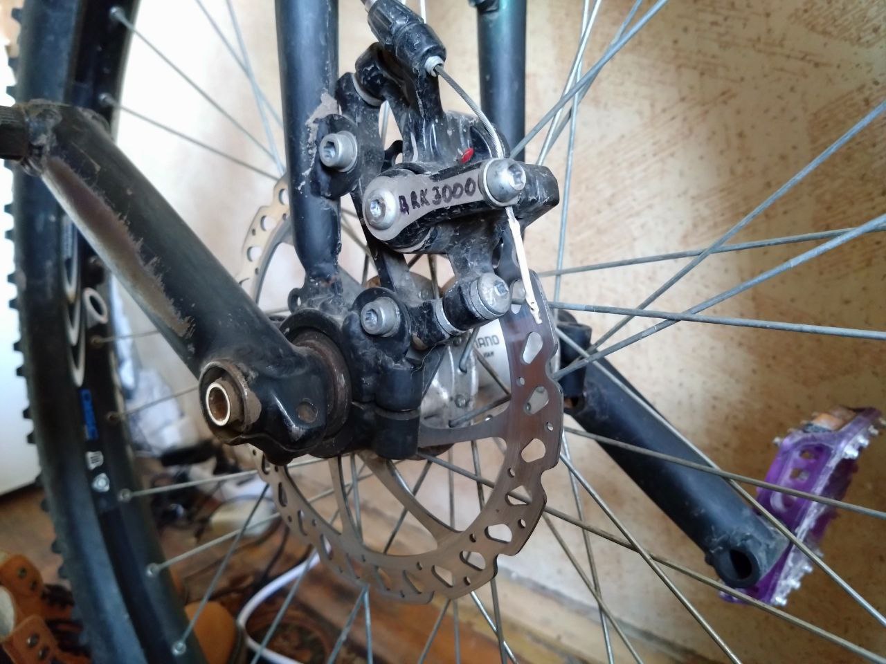

About the brake- I like mechanics because of low maintenance, good performance and ease of adjusting length of the brake cable. I had a long time ago an Avid Juicy 5 and it was mediocre. On my current setup I use noname caliper with a good cable, and it’s pretty nice. Despite not too straight rotor and poorly welded hub.
I ordered already the best brake- Avid bb7 (well, worse than older bb7, that made out of single piece of aluminum, but that mostly important for trials riding) Also got a modern Shimano Deore lever, was surprised it has a clamp for ease installing without removing grips. My older Deore on a current setup dont have that.

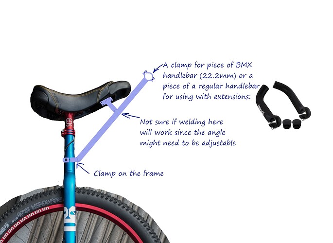

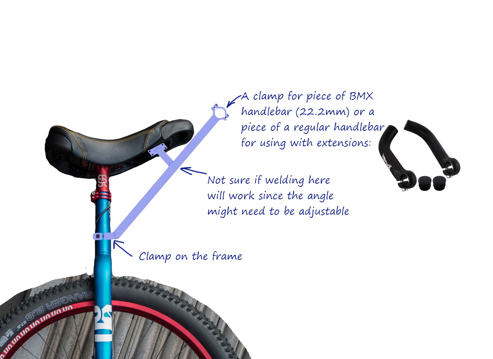

So at this moment I’m thinking about a Fusion One saddle + custom handlebars that will connect to the frame and the saddle. Flansberrium soon will make a prototype of that thing. I made a quick drawing of the concept. It looks like this, though the angles are not too accurate and i forgot to make it adjustable on the length.
