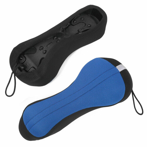

The KH free ride and street are both comfortable but you can add an air saddle cover to your stadium and I think you will find that will solve your problem for less money. Also riding will build up tolerance, if you are just getting back at it, it may take awhile to get used to things. A couple things I do is either wear an athletic supporter or padded bike shorts.

I bought padded shorts on Amazon, baleaf brand. I wear the padded underwear type and regular shorts on top. My problems had been keeping things in place and numbness in by butt, I really do not have an issue with chaffing. I am not a fan of the stadium saddle but I do like the older nimbus gel saddles. I am a big fan of the air saddle cover I have one on my nimbus 29er and my UDC 32 Titan both over KH saddles. It has made long rides possible for me. They do make an air saddle but I can’t speak for that.

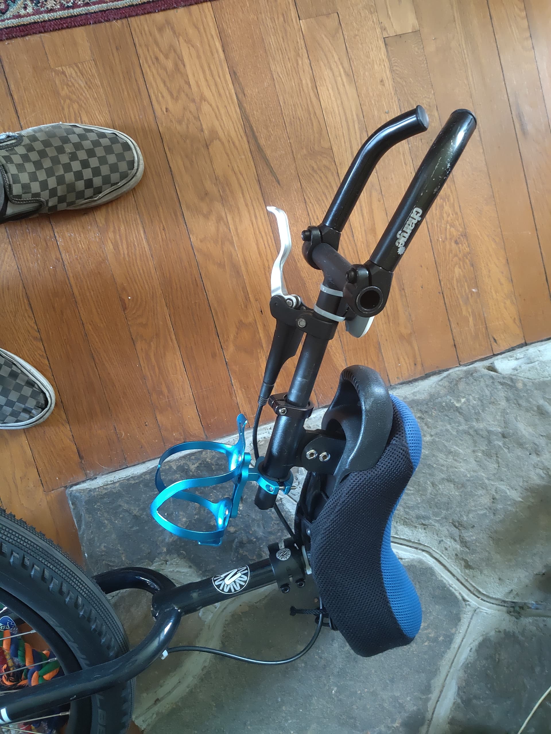

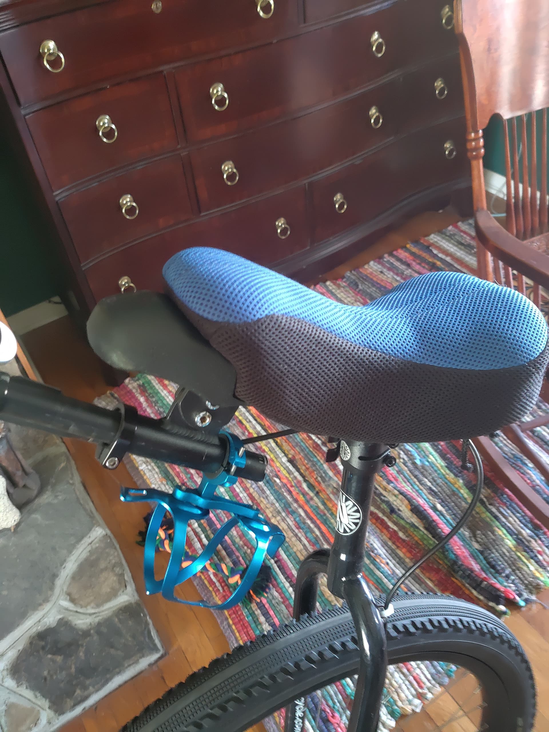

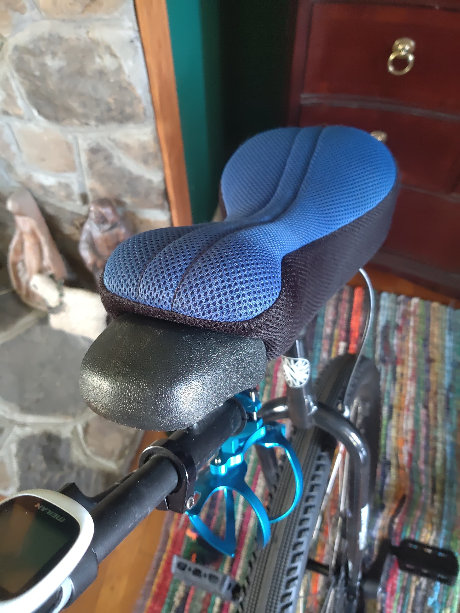

This will solve your problems. This nimbus air cover is overtop of my Kris Holme free ride saddle which is on my nimbus 29er road uni.
Here is the link to it on the udc website.
I wouldn’t be so quick to write such definitive statements.
For a lot of people the width of such a saddle (with or without an air cover) will just cause chafing at the top of the inner thighs.

I have checked out the air covers. They are in the back of my mind.I plan on riding through the woods when I get used to riding again. When I lose control I’ll just step off and let the Uni drop. I’ll save me first, If I can grab the Uni fine, most likely ,I’ll let it hit the ground. What’s your opinion on the durability of the cover hitting the ground ?
