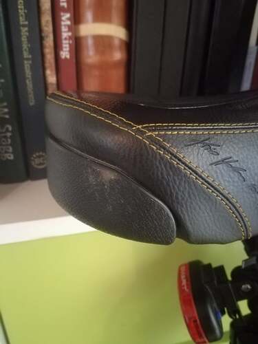

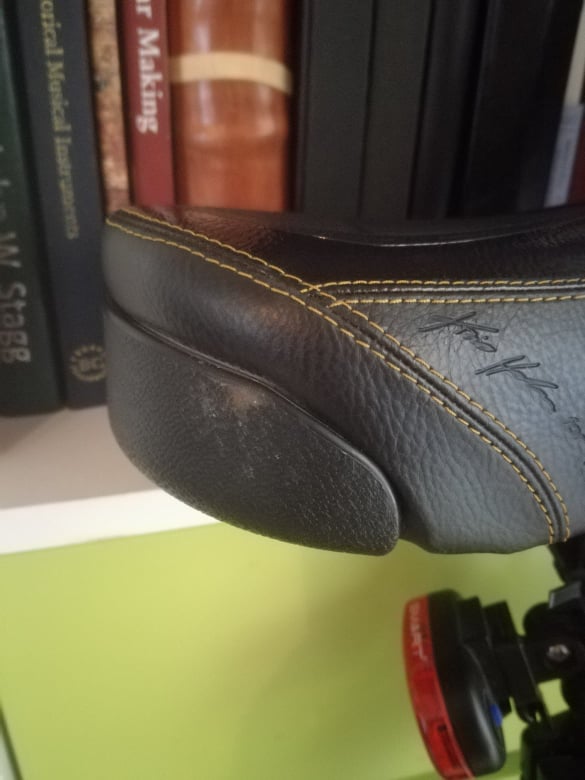

The leather on my stadium saddle is getting tears from hitting the ground. I would consider that normal wear and tear on a unicycle.
…but I think it’s completely avoidable; the bumper should be designed so it sticks out a bit - like the handle does. Just a ½ inch or less. Don’t you think?
Seeing my new Eleven saddle I’m getting worried how long it will last - they aren’t cheap after all.

I have similar wear on both Naomi saddles I use on my 20" and 24". My riding style and conditions rarely involve the saddle striking the pavement, though. I am wondering if, in my case, my considerable weight and posture of sitting on the back edge of the saddle…are not primarily to blame for the wear.
I agree, however, with your basic point. If the plastic back of the saddle stuck out more, that’d protect the saddle better.
Bumper and handle clearance to the soft material is certainly a contentious subject.
Yes, by moving the bumper further out it will protect the saddle more (1/2" is massive amount, it would not need anything like that). Although during design and research in to the saddle shape and position of the bumpers it was made clear that these hard plastic parts can and do cause problems when riding. Some riders were cutting the bumpers back to make them smaller so they imping less on riding/contact. As with most saddle problems, there is no answer that will suit everyone and the saddles tend to be a compromise that suits the most amount of people.
For the impact saddle… we are already looking at changing the materials to make the covers more durable.

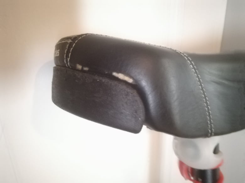

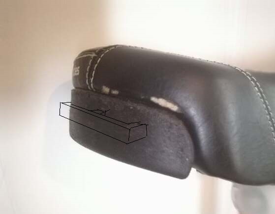

On my Fusion Zero, I added a second bumper, attached to the first one. It did well at protecting it since the original bumper had a purely cosmetic role.
I’ll see if I can find a picture.
Only picture I found - I didn’t keep the saddle that long… but at least it didn’t get torn even if my hack’s look is questionable. :wink:

If the plastic is higher up, some people will find themselves sitting on it. If it sticks out, riders doing tricks will catch it.
Nothing is perfect and I am always working on the next model, so do throw the ideas. Development takes time. Each modification also costs money and we need to get that paid for, so a mod to the tool as you suggest would be somewhere around $1000. We also try and keep things realistic on the prices, so mods tend to accumulate until we have enough to make a new tool.
