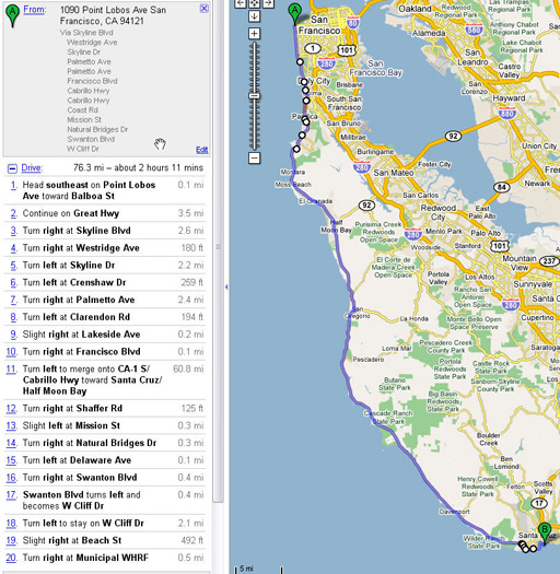

Here is the route we followed: http://tinyurl.com/387tmo
We also used this website to map our route and obtain an elevation profile:
http://www.gmap-pedometer.com/?r=1512756

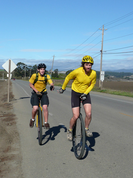

The new rider always starts in front. He’s waiting, riding below full speed, and the old rider is still going full speed - they meet, briefly, exchange the baton, and the old rider slows while the new rider continues. In the picture, I’m the new rider and Beau is the old rider. He’s at full speed and I’m just accelerating up. You can use either side, either hand, whatever you like to actually exchange the baton.

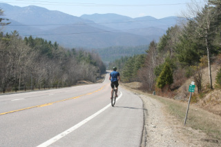

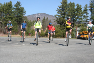

This past weekend three RTL teams met in Keene Valley NY for a practice day in the Adirondack Mountains. We were met with gorgeous sunny days, wide smooth roads with little (but courteous) traffic, big hills, and a lobster dinner.
Riders just before the start.
Vince on the way back down…yes, he had to go up that too.
Not everyone could make it so we had 2 teams of 2 riders, and one team of 3. The teams of 2 had to have the non-riding rider drive himself to the next switch point, but this worked fine. We learned a lot about what’s in store for us at RTL, and also had a lot of fun. We also all rode faster than we thought we would…which is fun. Given our smaller teams and hilly course we rode a slightly short-course of 65miles.
