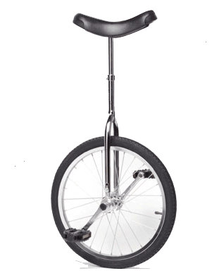

let me know what u think?
That sounds like alot of unicycle for the money, a must for anyone not (yet) needing something fancy! :wink:
any pics or links?
There is a review that looks strangely familiar at Bikewizard which includes a photo. It sounds like a good one to start with.
If that in fact is a picture of what you are planning on getting beware that it has Lollypop bearings this will probably be a fatal thing if you want a unicycle that will last for a while.
Maincap bearings are much better and for the price I’m sure you can find something in your price range.
The seat on this unicycle probably is alot less comfortable than how it sounds in the ad.
As far as wheel size goes. I think its more a function of what the unicycle is intended to do vr your height. (to a degree, yes sometimes for shorter people and kids even the lowest setting is too big with a seat post that is cut down all the way) Seat posts can be raised and lowered for a reason. IF your looking to deliver papers on your unicycle a 24 inch or bigger is probably best for you.
Look into what unicycle.uk has to offer for your price range if you have any questions about individual unicycles feel free to ask.
link
suprisingly i got mine from there
That was my first unicycle. It was branded “Cyclepro” when I bought it, but the bike shop said they got it through Raleigh. I still ride it today, on the rare occasions that I want to practice freestyle skills that I can’t do on a monty tire. I’ve replaced the seat, frame, bearings, pedals and tire, but the wheelset and cranks are still going strong after 5 years. Someday I’ll replace the wheeset, but it will still be the same unicycle in spirit.
I’ve been very happy with it because of how well it’s worked out for me, but I wouldn’t recommend it to anybody else because of the lollipop bearing holders. My frame original lasted way longer than most others of that design, but I’ve heard of people with the same unicycles who’ve had the frame fail after a couple days of riding. The seat is better than a savage or one of the skinny Torker seats, but it’s still pretty uncomfortable if you sit on it for prolonged periods.

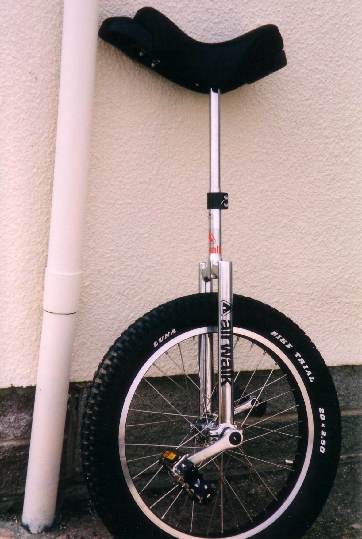

i think for a little extra money i got a far better deal it was from my local bike(“bikes are for people with extra wheel difficultys by the way”)any way as i was saying i got a nimbus 2 frame with a alex rim dx 32 which is great fun it has split bearing housing much better than the other ones hear is a pic the saddle and peddles have been added scence though so what do you think of this sorry that is is a bit big
