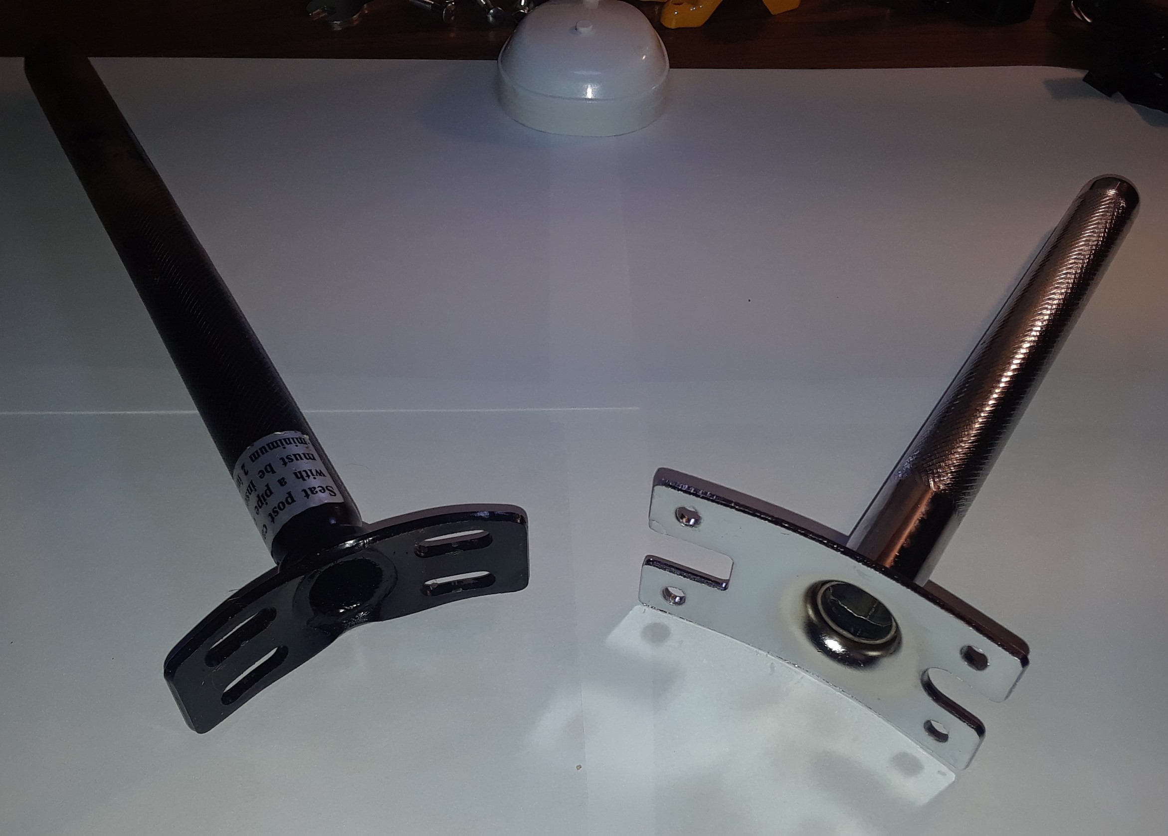

One of the issues you’ll probably encounter with used (or new no-name) unicycles is that the seat post is too short. The Cyclepro, a no-name Amazon unicycle, and even a used Nimbus II that I scored off of marketplace had seat posts that were too short for me. If that’s the case, you will have to throw a little bit more money at it to get the right length. Thankfully posts aren’t very expensive though.
To add, the saddle that comes with that unicycle might have a different bolt standard than most sold nowadays. If you do decide to get a longer seat post, if it looks like the bolt pattern on the right your options might be limited. The post on the left is the standard that most unicycles nowadays use, though you may have to buy a new saddle. This one is the least expensive one sold at UDC, and honestly its still worth the price.
I will vouch for a Club unicycle if you’re willing to drop a few more $$ on your first unicycle. It’s labeled a beginner-oriented unicycle, yes, but it’s a guaranteed solid unicycle with up-to-date parts. You can order it with the correct length post and a modern saddle and not worry about parts compatibility and whatnot :slightly_smiling_face: It looks like the prices on UDC USA have been upped a bit due to tariffs unfortunately, but you might be able to get away with the Hoppley 20”.

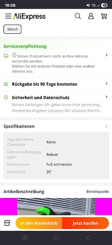

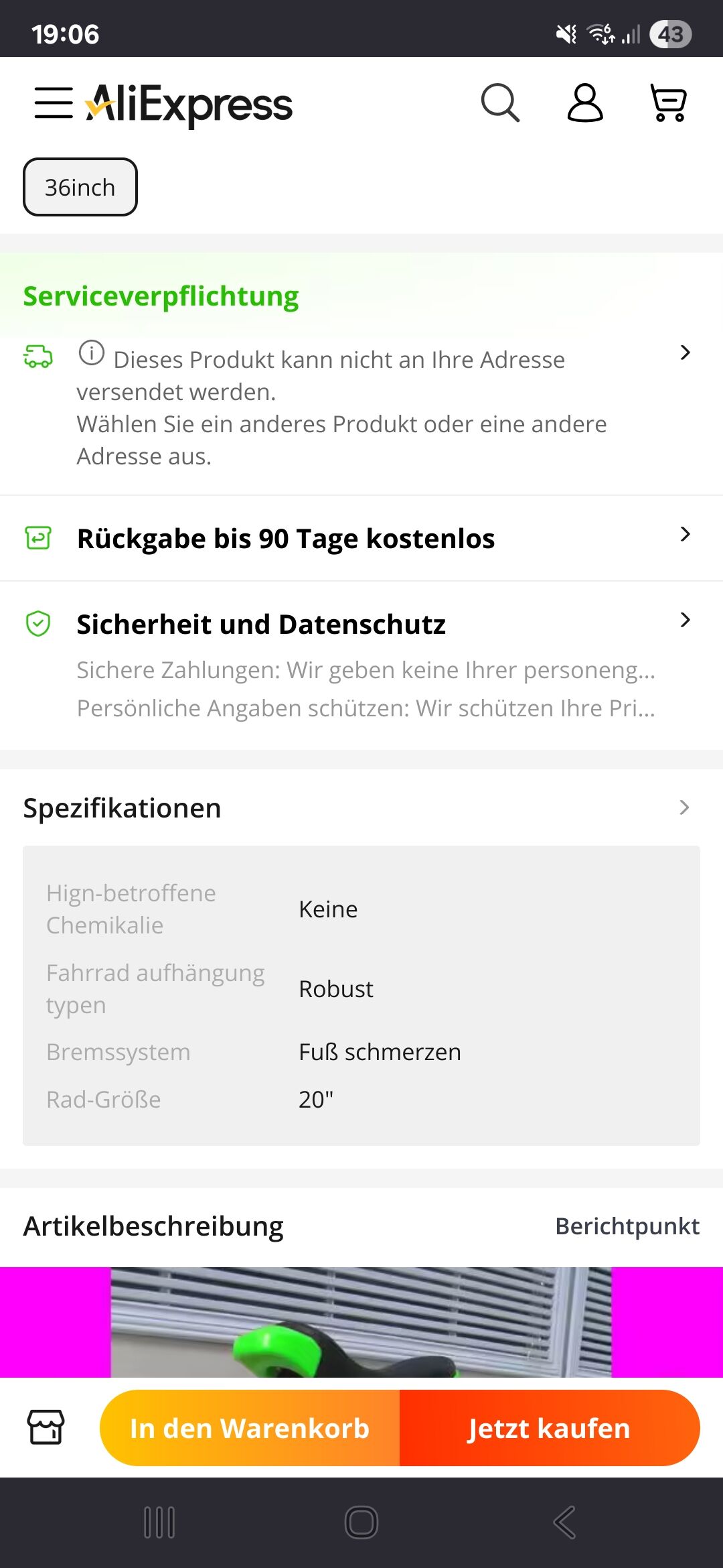

FootPain
…I can relate :laughing:

I like the brake system :grinning_face:
in german:
“Bremssystem Fuß Schmerzen”
should be something like
“brake system foot pain”
in english.
