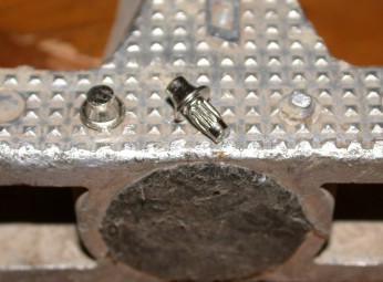

I have some Primo super-tenderizer pedals and I can’t get the pins out. The pins appear to be a press-fit.
I tried pulling them out with needle-nose vicegrips but they slip off because the pins are too rounded down, and then I tried sticking a small screwdriver under them and prying them out, but I can’t get under them.
The pins I’m trying to replace don’t have access on the backside of the pin so I can’t pound them out. How do you get those suckers out of there?

I believe the pins are replaceable because they gave me 6 extra pins in the box that the pedals came in, and I was able to knock one pin out where I had access to the backside of the pin.
The particular pins that I need to replace don’t have backside access so perhaps they weren’t designed to be replaced.
Anyways, I was able to drill out a pin and replace it with a new pin after tapping it in with a hammer. I would have to replace 16 pins this way, so I may wind up replacing the pedals.
The attached picture shows my replaced pin on the left, a loose press-fit pin in the middle, and a rounded-down pin on the right.

Thanks guys, but the pins are way too soft to get a good grip on them with any kind of tool. I’m almost certain now they’re molded as part of the pedal body as Jason suggested. But I can still add more pins than the original and create a super-grippy custom pedal.
The pin pictured on the right is not replaceable, the only pins that are replaceable on tenderizers are the ones on the crossbars, I think.
