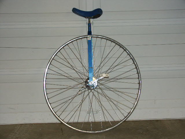

The 40" TUF big wheel is rideable again! I have named it BIG BLUE.
I ordered Tommy’s extra hub and new bearings. The replacement hub arrived at 8:00 PM last Wednesday, UPS must have been behind that day. I dropped it off at The Bikesmith over lunch on Thursday and it was ready by quitting time yesterday.
Val at Bikesmith was able to get all the spoke nipples to spin without having to remove the hard “wheel chair” tire. The swap went through without a hitch. John will be very happy to hear he used loctite to secure the bearing to the axle. The new cranks were securely installed with a cotter press.
As soon as I got home I spun on the new pedals and took her for a ride. I tried a couple free mounts but got impatient so did a mailbox assisted side mount and launched off first try. The first thing I noticed is the amount of wobble/twist you get with that hard tire. The thing pivots on a very small contact patch and was quit squirly at first. This also makes for quite effortless turning though.
On a brief 1/2 mile round trip I found the old seat foam was not quite as cushy as I thought it would be. Road shock comes right up through the seat, you feel every little bump. I then did an air seat conversion to the old Schwinn style seat with vinyl cover. The second trip out took four tries before I could successfully launch, go figure. After a couple adjustements to the air seat I found the bumps much less noticealble.
I’ve posted new pics of the hub exchange and air seat conversion. Unfortunatly I had to be at work during the swap so I do not have photos of the disassembly and reassembly:
http://www.unicyclist.com/gallery/bigwheelhubtransplant
I’ll take it out again today when we get some day light and add a couple more pics.
