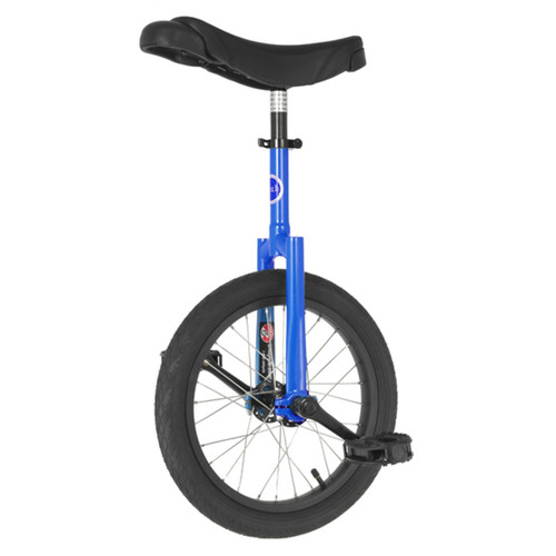

I would probably pay a little more and get the UDC Club 16. It seems like the best 16 out there. Also, the frame appears to have more clearance, so if you wanted to rebuild around the mini trials concept you may have enough space for a 3" tire.

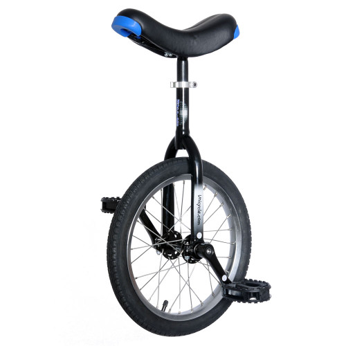

Now that I understand better what you plan on doing I would also recommend a 20" uni. For a starter uni that can handle a full sized adult I don’t think you can go wrong with a Torker LX 20, or a UDC Club 20. I don’t know if you can wait, but if price is a real concern Unicycle.com has an annual sale coming up after thanksgiving. They normally do free shipping, and knock the prices down quite a bit. It may be worth waiting for.

I think I found the torker you were talking about:
http://www.unicycle.com/unicycles/bymanufacturer/torker/torker-unistar-lx-20-inch.html
It’s not available and I also notice a cheaper torker - cx 20. why not getting it?
http://www.unicycle.com/unicycles/bymanufacturer/torker/torker-unistar-cx-20-inch-blue.html
