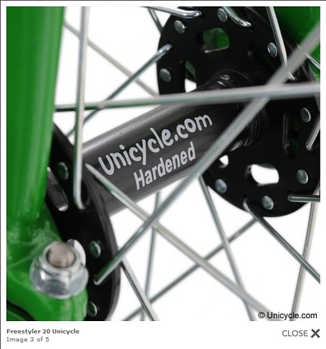

It is CrMo says hardened steel. I wouldn’t bother upgrading a club uni to ISIS since it is an entry level cycle and with ISIS hub and cranks it will still be entry level with ISIS. Personally I would keep the club as a freestyle or leaner spare unicycle and buy an ISIS one seperately- hopefully before bending your soft steel cranks.
So in your opinion Roger, why are the UDC hubs not weak like the cheap unicycles, if they are not made of Chromoly? What magical material are they made of that is not hardened steel that is harder than steel and is cheap like steel? The good news is the hubs are relatively strong!

Ok maybe I spoke too soon as my freestyler unicycles are not with me. I have an axis unicycle with Unicycle.com CrMO hub. Of course Roger knew better than me- sorry Roger. I wonder if they heat treat the Club freestyler hardened hub to make it harder than normal, or if it is case hardening.
Freestyler hubs are strong enough for their purpose- maybe they are not as strong as Chromoly.

It is a mistake on their site, I will ask them to change it. The hubs on the Club are not CrMo, but are a high carbon steel that has then been hardened.
There are thousands of types of steel and also many different CrMo steels. They are all have slightly different in their composition this gives them different characteristics. These are further changed by the way the steel parts are constructed and treated. The hub on the Club unicycle is made from two steels, one for the flange and one for the spindle. They are hardened after they have been constructed to give them an appropriate harness and toughness for their use. The number failures confirm this is the case.
Why is it better than cheap hubs… I don’t know what material they are made from but it is certainly not hard or tough and I very much doubt that they have been any where near a hardening oven! (This I also suspect goes for some of the cheap ISIS hubs we are seeing now). We tested a whole pile a few years ago and had figures for the cheap hubs at below 150 Vickers. The Club hubs are somewhere around 400 and the CrMo ones are about 580.

I don’t think it is a mistake on their site, it is more like a mistake with my sight reading their site- sorry. I must have remembered that it was hardened and mistaken it for the same thing as Chromoly- knowing that hardened is better than the ones that break easily.
