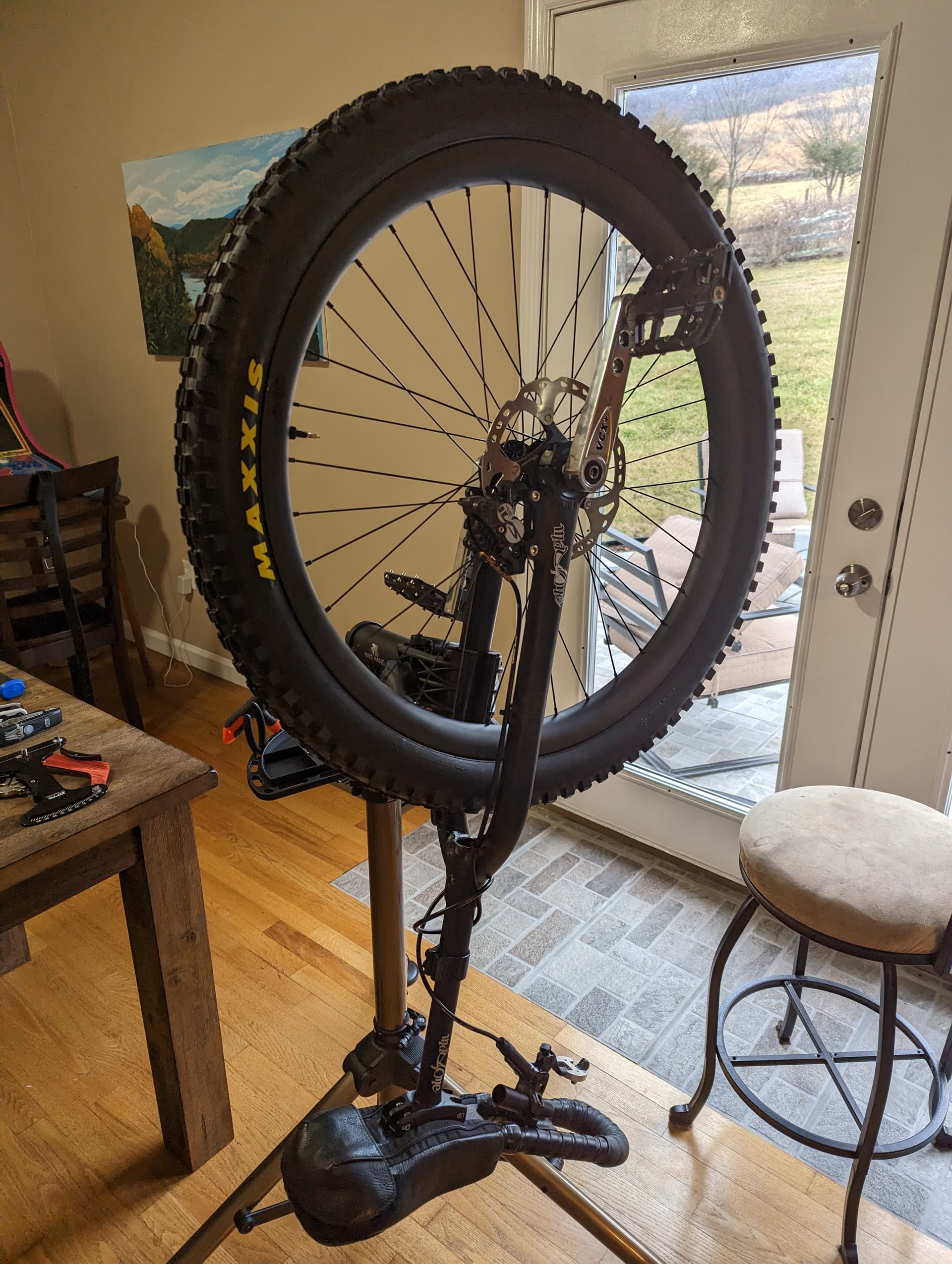

The final product on the Mad4One.

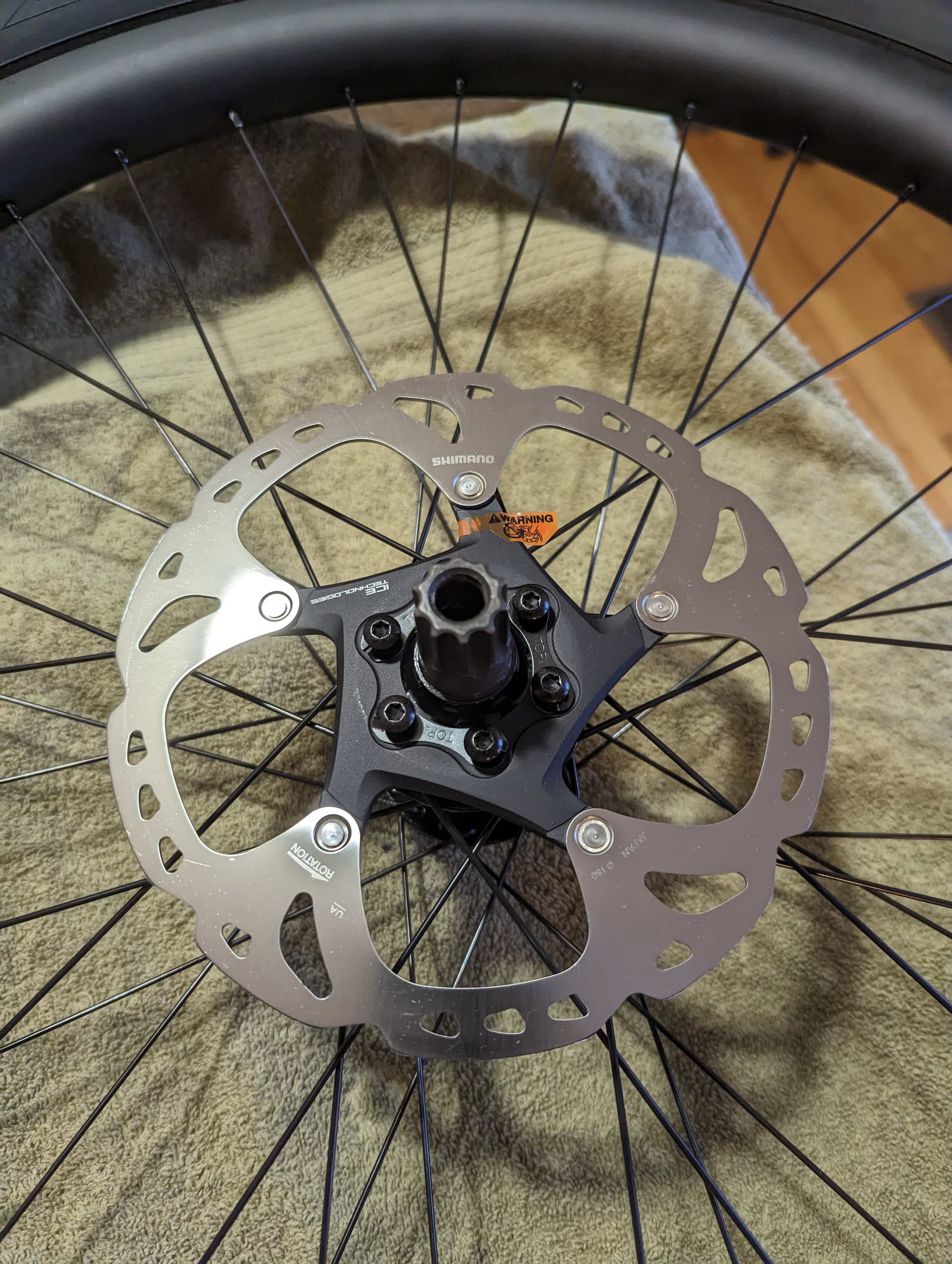

Rotor installed!

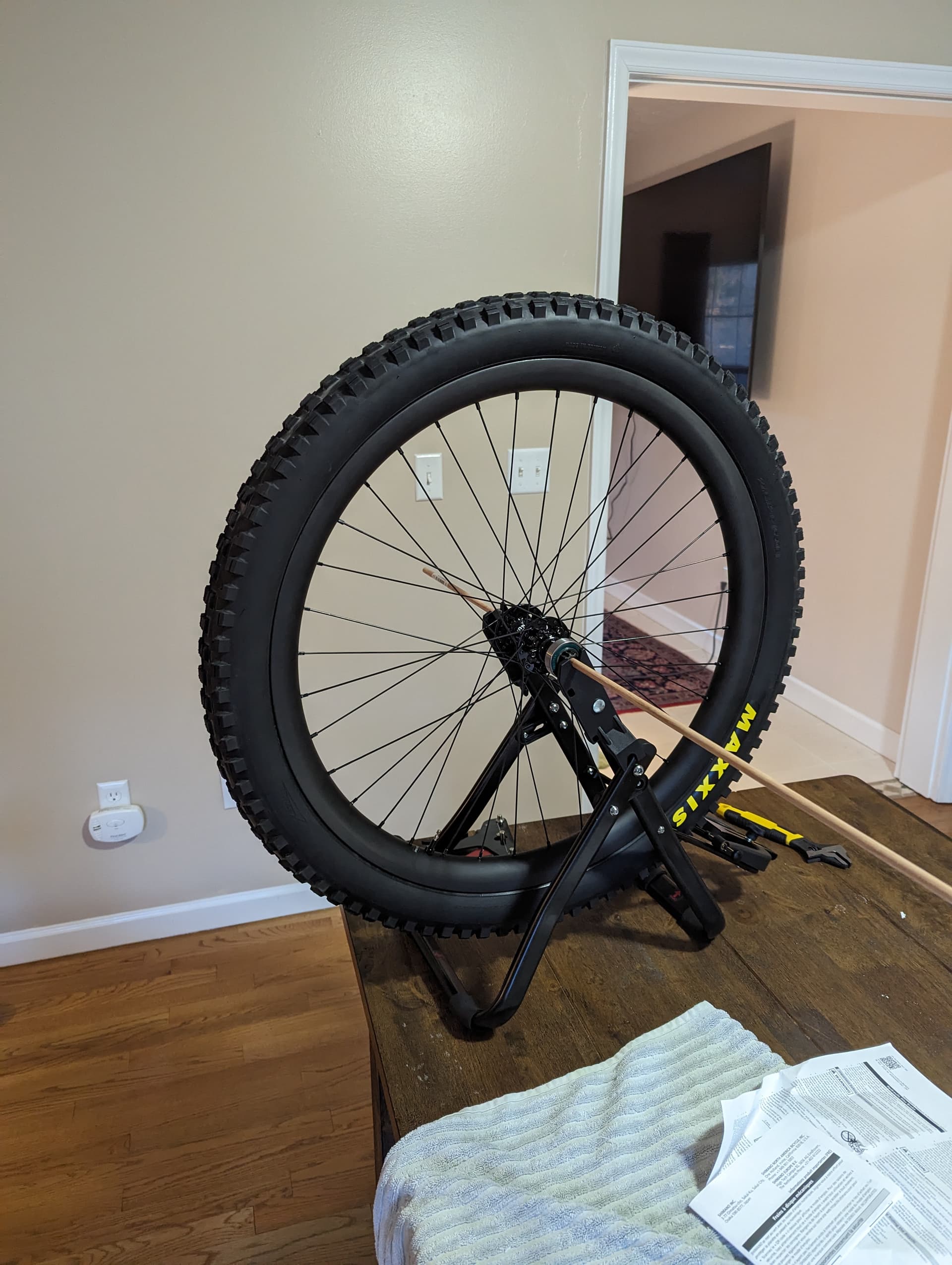

Got the tire on.

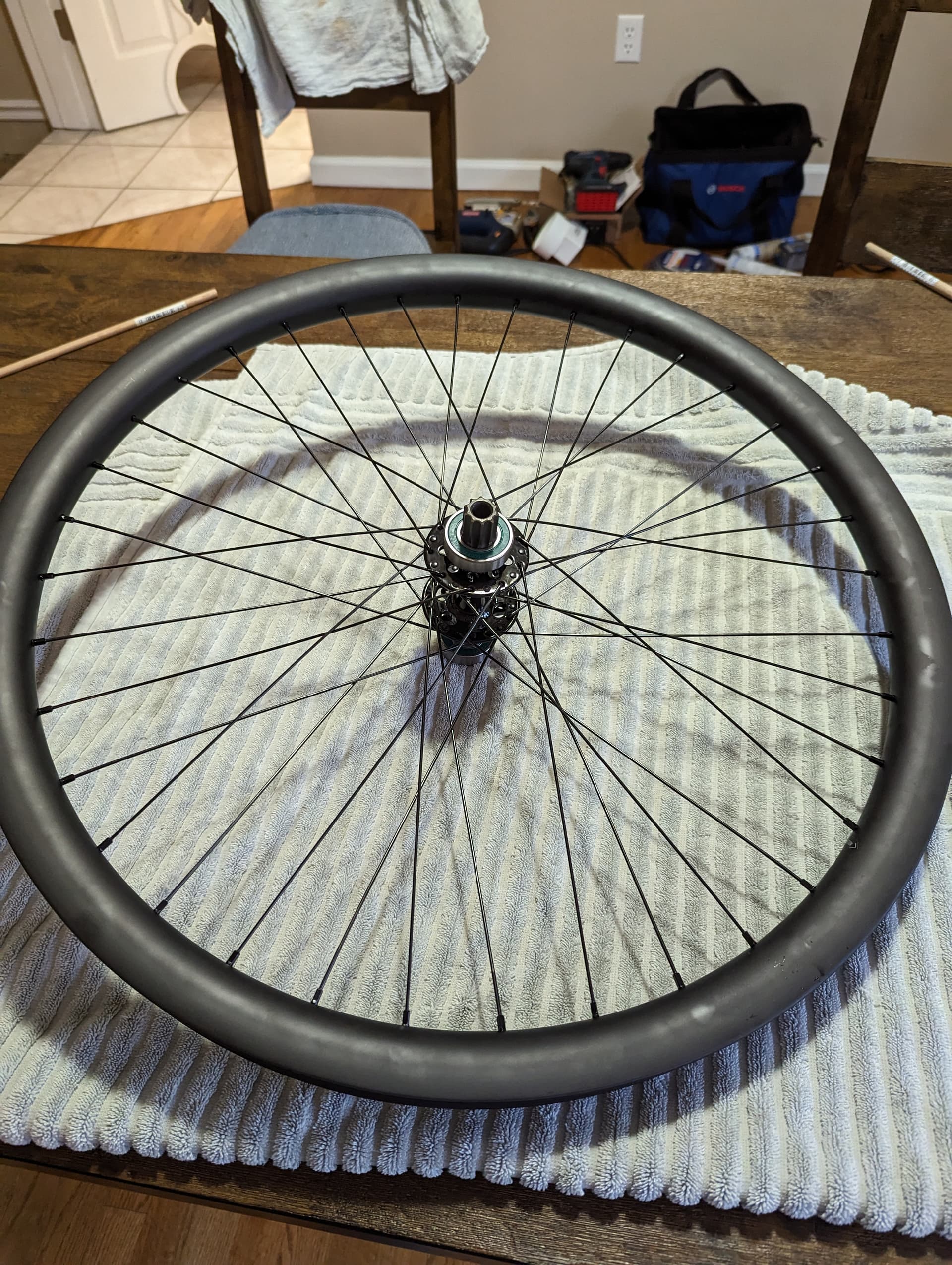

All laced up.

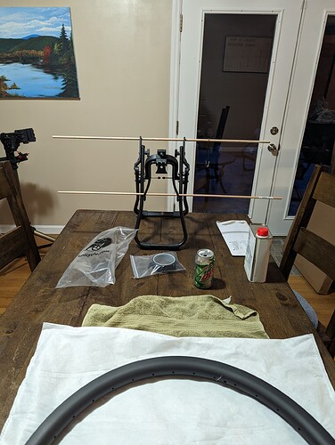

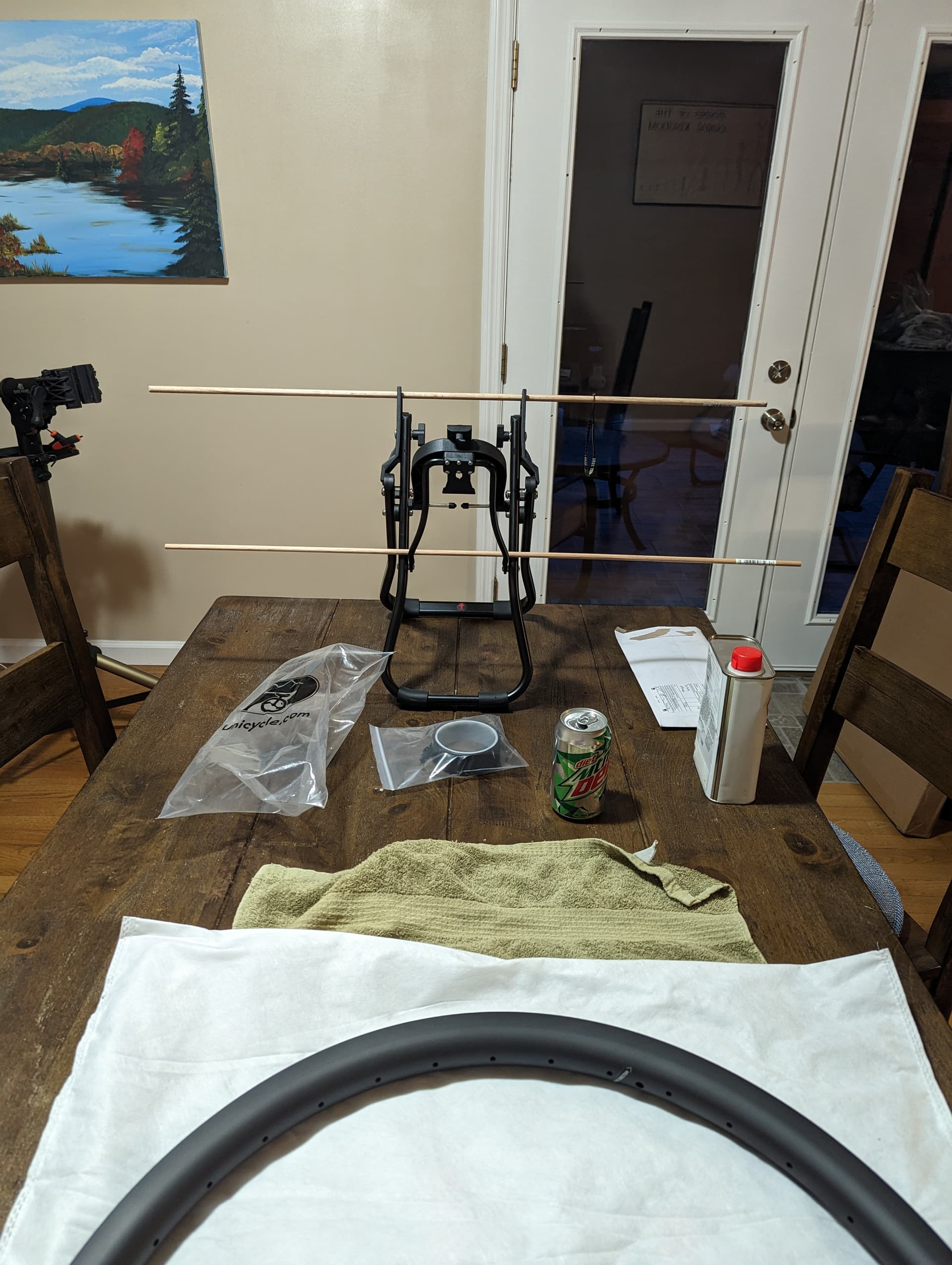

Just a worktable shot.

Yeah so here’s the thing: I don’t have a compressor. Thinking about getting one, but it’s one more of the complications or layers of complexity here. Anyways I seated a tire twice with a regular hand pump.

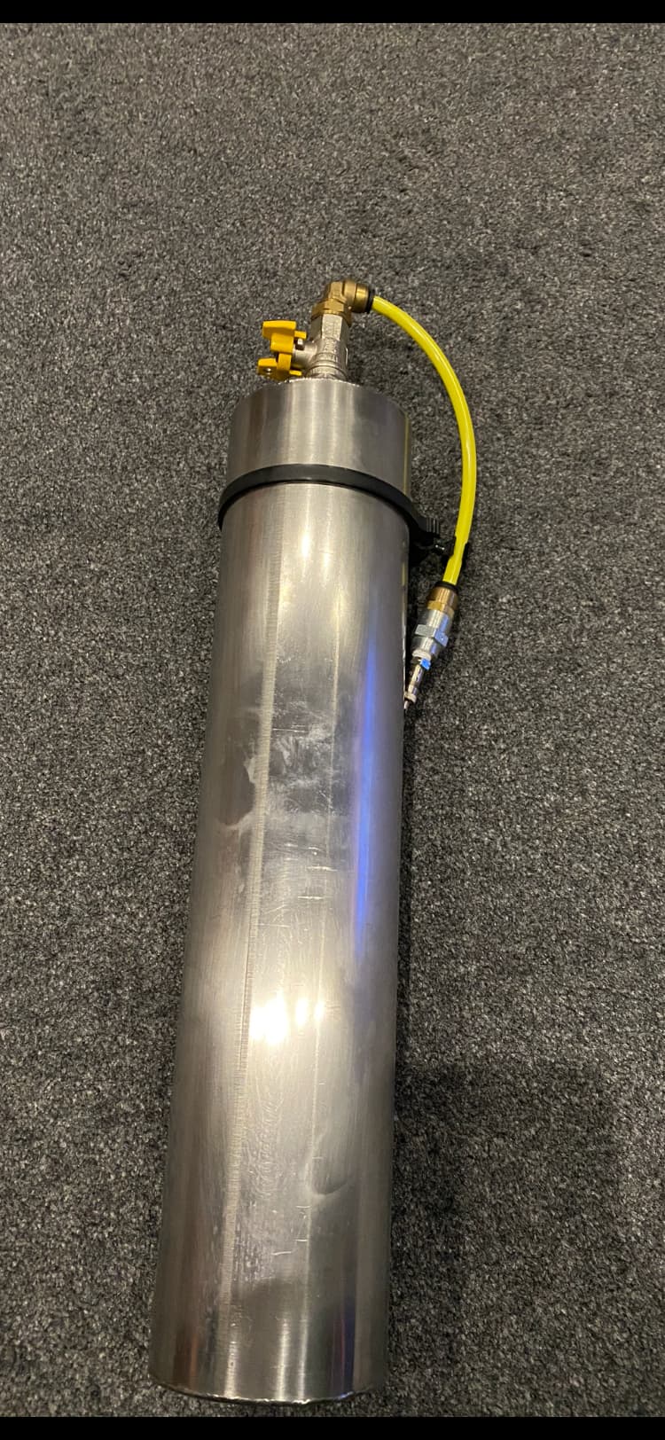

If you don’t have a compressor you can get charge bottles, it’s a canister that you pump up to around 100 psi using a track pump so that you can rush the air in to seat the tyre bead.
There about £50 but I made mine for next to nothing using parts from my work.
Woah. I love it. I want one.
Fair enough, good on you for doing it with a hand pump I wouldn’t have contemplated that; I always just screw the pressure up on the compressor so it gets dumped into the tyre :slight_smile:
It worked fine. For a quick second it seems like it won’t happen, and then it does.
