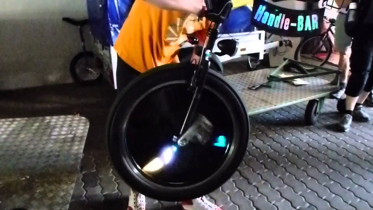

Yeah! i have some outer rim ones on my 20", but it doesn’t do POV (ie: logos). I know Nik, from Switzerland, built the “Handy-Bar” that does do this.
There aren’t any products out there that are purpose built for a unicycle. Nik used a geared uni to achieve higher speeds, AND so the crank wouldn’t block part of the image (given the relative crank position changes at any given time when geared up).
