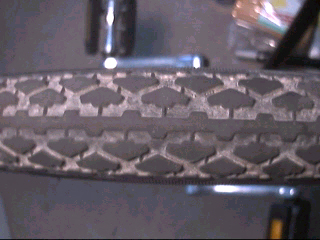

Both cranks are 5" from hub to pedal base.
The tire came with the uni and is marked:
Schwalbe 47 - 622 (28x1.75) HS159
I’ve been having problems with AOL’s file space for most of the month, so this
picture may or may not be available…
If the image won’t show, the tire has what I can describe as a center ridge
with triangularish knobs in a zigzag pattern on either side of it. It looks
pretty symmetrical, but I will try replacing it today and see what happens.
Thanks!
  • Joe

The AOL link isn’t working, but I found a pic of the Schwalbe tire at <http://www.schwalbetires.com/Cat3Schwalbe159.html&gt;
It looks like the tire has a bit of a “V” profile. The “V” profile combined with the center ridge could be causing the problems. Try finding a tire with a more round profile with no center ridge and with an even tread pattern.
Anyone know of a good 28" tire that would fit Joe’s rim?

I got another tire today, branded “Serfas VIDA,” marked:
35-622 (700x38C)
This one is a bit more rounded I think. It doesn’t actually say 28" (I couldn’t
figure out a good way to put that in quotes) anywhere on it, but seems to fit
perfectly. I switched the tires at the bike shop and rode a few miles. I now
feel no tendency to lean in either direction more than the other. So it appears
that the tire was indeed the problem! Thank you MUCH!
The tire pictured at the Schwalbe site has the same tread pattern as my old one
but apparently takes higher pressure than mine (I think mine takes 45 psi; I
don’t remember now and the tire is down in my car and I don’t feel like running
down to look at it). Now of course I have other things to adapt to, like
suddenly riding on about 70 psi, which makes for a much more, ah, lively ride.
Being able to track a straight line is sheer bliss though, compared to before.
I’ll look around for a lower-pressure tire with a proper tread. I may just get
used to this one though. It has Kevlar! Ooooo!
I am able to view my images now. They may not work for you. Anyway here is the
new tire:
And the old one again:
Thanks again!

The problem with tires with a center ridge is that you never end up riding directly on the ridge. You are either riding on one side of the ridge or the other which causes a constant lean and a constant tendency to turn to the side.
Looks like your new tire is a good tread design for a unicycle.
