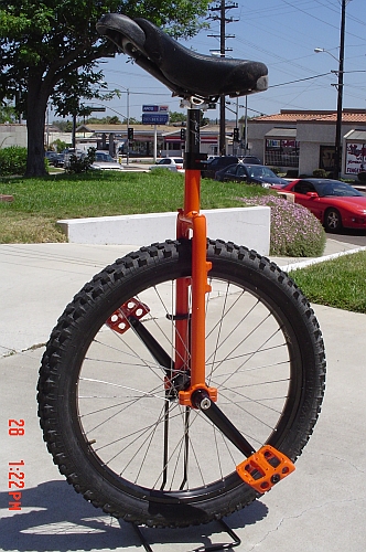

tight, is that spencers?
Mine Muaaahhhhh!:stuck_out_tongue:
