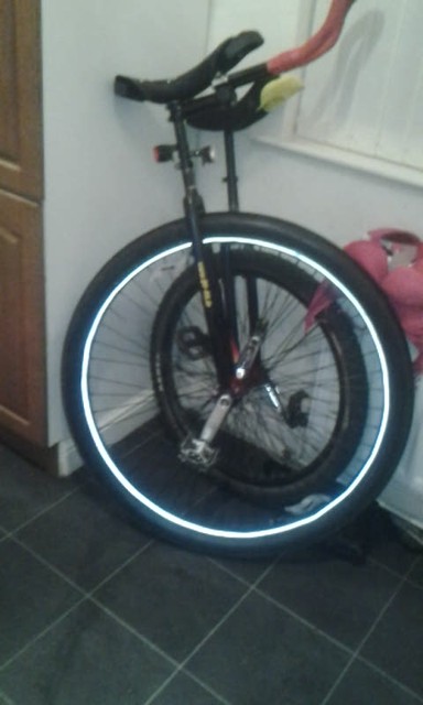

You may want to try flipping the stem (so that it angles downward) and mounting that as low on the seatpost as possible, hopefully getting it close to where you have it now.
You could also try a shorter stem to move the whole mechanism closer to the seatpost. Do you know what size it uses? I was kind of curious myself about that. I really wish they threw in a stoker (tandem) stem (length adjustable) instead of the clamps to move the bar itself back and forth. That would have solved the issue right there. I’ve really been interested in this bar, but I think I’m going to use it as a rear rack instead of a handlebar, so I shouldn’t have problems with leg clearance.
Fantastic Uni btw : ) that thing is so fast with the knard on it. You can just plow over stuff with the right pressure.
When I had it on my previous muni, I tried about every possible configurations including flipping the T part.
I have different cylinders to fit it on the seatpost (it came with the handlebar).
I agree, an adjustable stem would have been great.
At least a longer one would be great, maybe I would manage to find some bike parts that fits.
this whole thing adds some weight to the muni, that’s a pity, but since I got used to the handlebars, I find it difficult to step back, not only it ads control , but without it I just don’t know where to put my hands anymore, and I don’t like holding the seat handle for a long time.
When I see unicyclists holding the seat handle with one hand, ore even worst with both I feel like they need to pee :smiley:
This evening I found a way to mount the brake lever in the loop of the handle.
the extremity of the lever is close to the front end of the loop and I can pull the lever by my right fingers.
the lever is still protected by the loop when UPD.
Have to test it when I’ll mount the HS33.
Or I’ll go the classical way: under the saddle, with the kh spooner (and people will think I need to pee :smiley: )

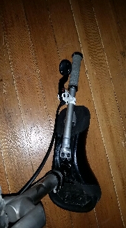

The only way I managed to stop myself rubbing on the T section of my Qu-Ax handle was to jack it as high up as it’d go (Literally touching the seat). That way, the seat itself would shield my legs from it.
Pic:
Can clearly see where the black paint as rubbed off the sides. This handlebar is great is every single way except the leg-rubbing! :angry:

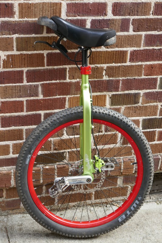

Here’s the latest iteration of my 26" “Oracle” (now with only a few remaining Oracle parts). Parts are:
  • Mad 4 One medium muni frame. I swapped out the Oracle frame because I wanted:
    • a proper disc frame (the d-brake was giving me problems)
    • a little more tire clearance
    • 27.2 seatpost size
  • semi-flattened KH fusion freeride, tilted way back courtesy the…
  • KH adjustable post (one piece base, only available in 27.2, thus my requirement), with the original Oracle clamp
  • KH moments, 150
  • Impact Addict pedals
  • cheapo Tektro brake
  • original Oracle wheel with 3-piece pinned Nimbus disc hub, and Dominator 2 rim
  • WTB Ranger tire, 26x2.8", the “fast rolling” “tough” version.
The color scheme was perfect for the Christmas season…
Where do you get one of those handles? Looks just like what I want.
Thanks Stewart
handle
