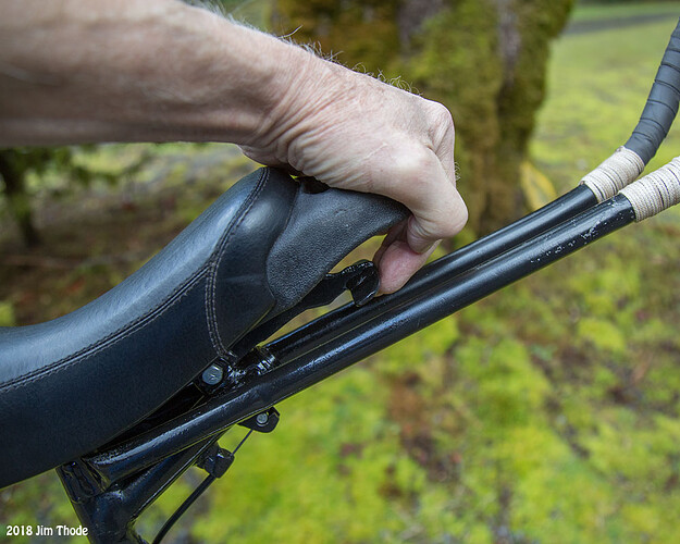

I agree that bike brake levers are not ideal for the basic mounting under the seat, although the KH spooner really improved this back in the time of old Magura HS rim brakes. I’ve also modified quite a few spooners to fit disk brake levers.

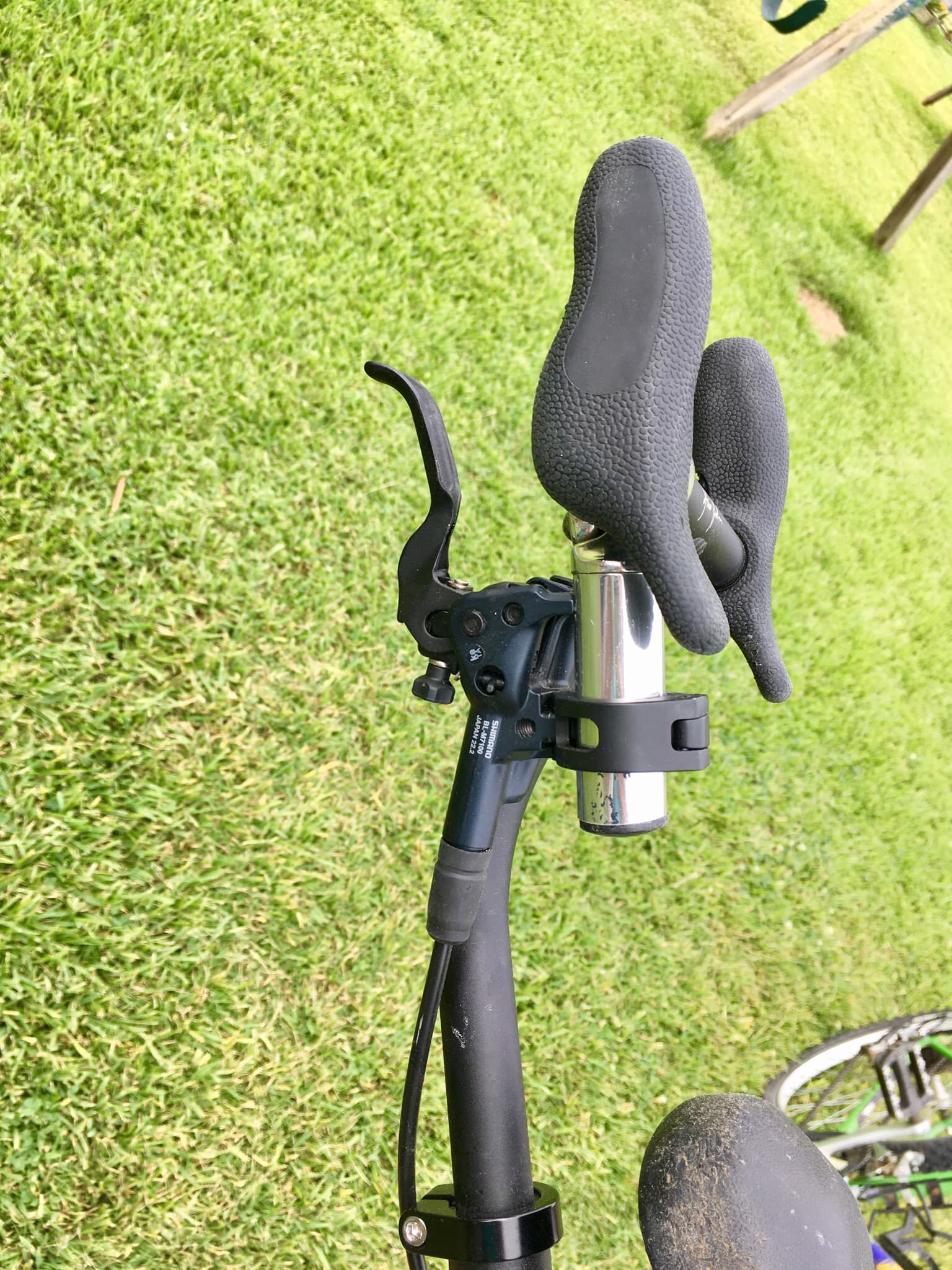

With bars I think normal levers are just fine if you install in them in a manner that’s more similar to how they would be used on a bike.

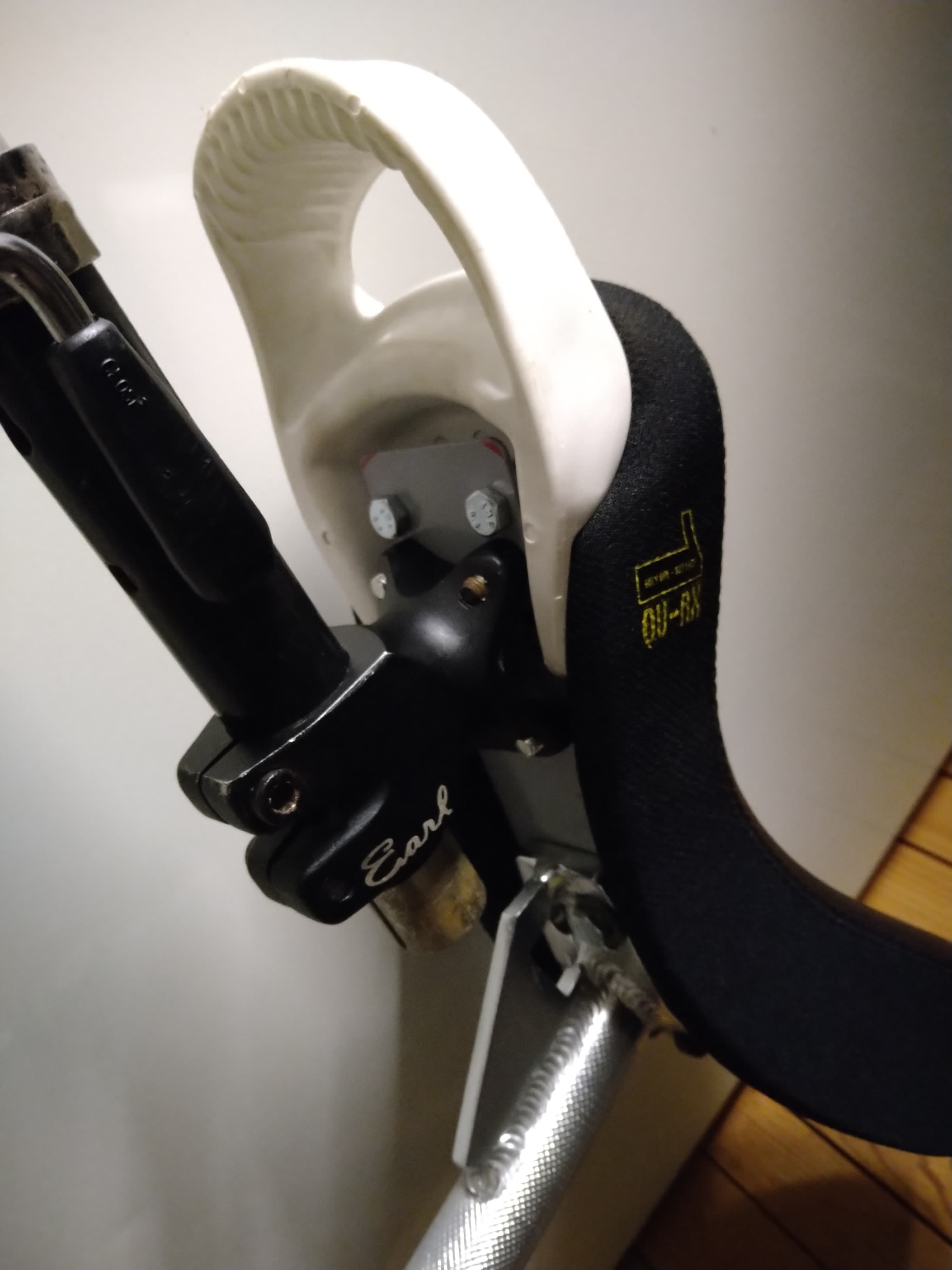

That’s a cool setup! What’s this part you added?
I made my lever longer and larger to be ambidextrous and useful with short grab or long grab hand position
I agree! I think its a bar end from a bicycle.
I think i have an old set of bar ends. Definitely Going to try this!
It is indeed a cheap handlebar end with the curved bit cut off.
