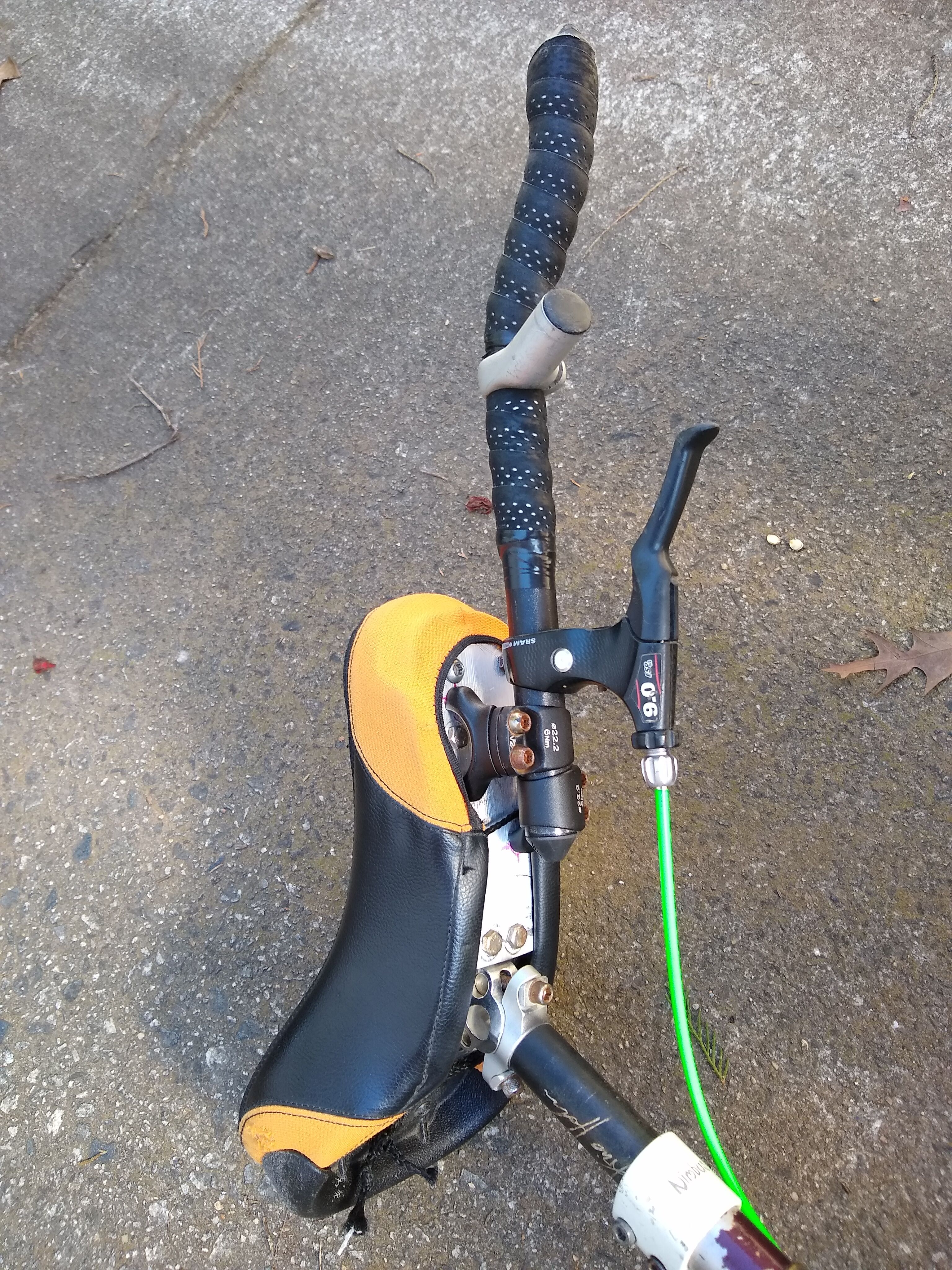

The setup would need to survive an impact with the ground/street. And the hardware would need to handle strenuous twisting, pushing and pulling. My concern is that the twist shifters would break almost immediately.
If a durable, functional prototype could be made, the question still remains whether the rider could control braking and maintain control of the bar ends, without one of those functions interfering with the other.
Many good riders are already able to do this using a typical brake setup. Maybe I am just not that talented, but I always thought there had to be a better solution to the brake setup.

I did some quick research, and some bar ends have the same 7/8" diameter (22.2mm). Not a deal-breaker, but it’d be nice to keep the curved ends of the bar (see my picture above). Wondering if the tolerances of the twist shifters allow them to be slid over the bend in the bar end.

I repurposed a set of clip-on aerobars that a bike shop was throwing away, into a handlebar for my 29" wheel that I use for errands and casual road riding.
I used just one of the bars, but both of the handlebar mounts in tandem, bolted to a KH-style homemade stiffener plate. Result is rock solid and works well, though I would like to to be able to adjust the angle - I’d like to point it a little downward.
The silver bar end stub is to lock my hand in place when I’m climbing, and pulling up on the bar.
@MrImpossible I have never tried such a setup. I am sensitive to changes in the width of of my own bar setup. I narrowed the Shadow T on one of my unicycles and wasn’t happy with the outcome. I would even consider widening my bar setup, though that is limited by the stock width of my Shadow T. Your setup is as narrow as they come. I imagine that a certain side-to-side leverage I get on my own bar setup would be absent on a single bar-end. Also, my handholds tend to be more inward-facing. Ergonomically, I have trouble imagining being comfortable, having a natural wrist position, on your setup. I assume it works well for you…
For riding one handed, I really like a single centered pointing-straight-ahead grip. The only wheel I ride two handed is my 36", which does have parallel grips at the end, but even that one I mostly ride with one hand in closer, on the single bar part.
