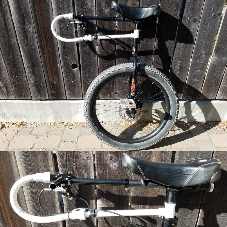

I made another version with a longer bar which enables me to do one-finger braking.

Donāt you find it more troublesome to have the brake more to the front? Because of the T-Bar on my 32", the brake handle is also in front of the seat, but when going downhill, it makes balancing a bit more difficult I think. With handle right under the seat, closer to the centre feels better.
Unfortunately waited too long to be able to edit the previous message. Anyways Waalrus, another thing I noticed with your handle bar, where are the handles, there is only a bar ![]()
I completely agree that closer to center feels better, especially on the freewheel. My hand position is actually very similar to what it is when the lever is mounted directly under the bumper. Itās just turned 90 degrees so that I can use a single index finger to brake. There might be a way to have a differently shaped bar (maybe J) so that the lever could be turned so that itās more like a lever on a mountain bike but that configuration might have more a tendency to snag on legs during a UPD and it might be more difficult to protect the brake hose.

It may be difficult to see in the photo since itās black but I have a grip on the bar where I hold it. On longer rides when Iām mostly pedaling (vs. coasting or brake-coasting) I put my left hand over the right one just slightly ahead of it.
I put my original handle on my fixed unicycle and am trying out this new one on my freewheel unicycle. I cut about 2" off the bar and this is the longest the brake hose will reach. Instead of cutting off the top of the T I attached the flexible PVC coupling to a cut off handlebar end.

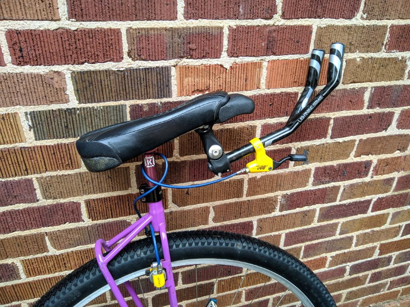

Probably a bad idea to put something light and fragile on the front of a unicycle, but I couldnāt resist this cool carbon fiber aerobar I saw on ebay for $25. Itās from a Profile Lightning Stryke clip-on aerobar kit.
I wish it were a few inches longer, but otherwise I like it. Still have to put some handlebar tape on the grip areas, and figure out a bumper so it might survive a crash.
That looks very nice. ![]()
Iām guessing it is most likely to break where the bar goes into the stem. If you could find a way of joining part your other bar onto this it would lengthen it and maybe stop it breaking there too. Getting a piece of tube the right diameter to go up inside the carbon and alloy tubes might be difficult though. If you got something a bit smaller some glassfibre/epoxy body filler might do to pad it out and bond the smaller tube inside though and strengthen everything up.
I had a set of Profile Design carbon bar ends mounted on the underseat bars on a recumbent at one point ā I was pretty sick when I came off it and damaged those. I hope this setup lasts a while for you.
that is a nice looking handlebar. I hope you can find a way to protect it.

@mr impossible- nice work on your handlebar set up. I like the clever use of the adjustable stem. With your new carbon bar, have you thought about flipping it over and increasing the angle on the stem? It might give you a more flat handle position out in front which you may find to be more comfortable.
I did try that; it sort of works. At the maximum up angle, the handles are still tilted slightly downward, and are closer in. With just a little more up angle, and distance, it would be pretty good.
It does seem to offer a little more crash resistance, since the bars will hit straight down, and the bumpers I put on the end will work better.
