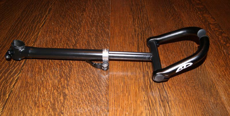

My bars aren’t that custom…just a standard T7 handlebar from Unicycle.com with some drops from REI added on. I really like the set-up so far though, and it’s been great for some recent MUni action too.
Wow, unihopper those are sweet handlebars :astonished: What’s that part that looks like stem, recycled b*ke? :slight_smile: Whole concept looks clean.
Thanks! It is the neck of a scooter welded to the part of a bike where you insert the seatpost.

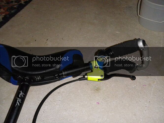

I made one similar to that that I used for MUni for about a year until the mount broke.
Here was mine when it was first made
Chunk of seatpost stuck on a brake mount flipped backwards with extra mounting holes drilled in seat base. back end of a T7 bar clamped on with replaceable bar ends.
I am going to make a replacement mount sooner or later but instead of starting with a brake mount I am going to weld a tube onto a plate that goes all the way back to the front seatpost bolts (like a KH reinforcement plate).
Strong, light, great for muni.
