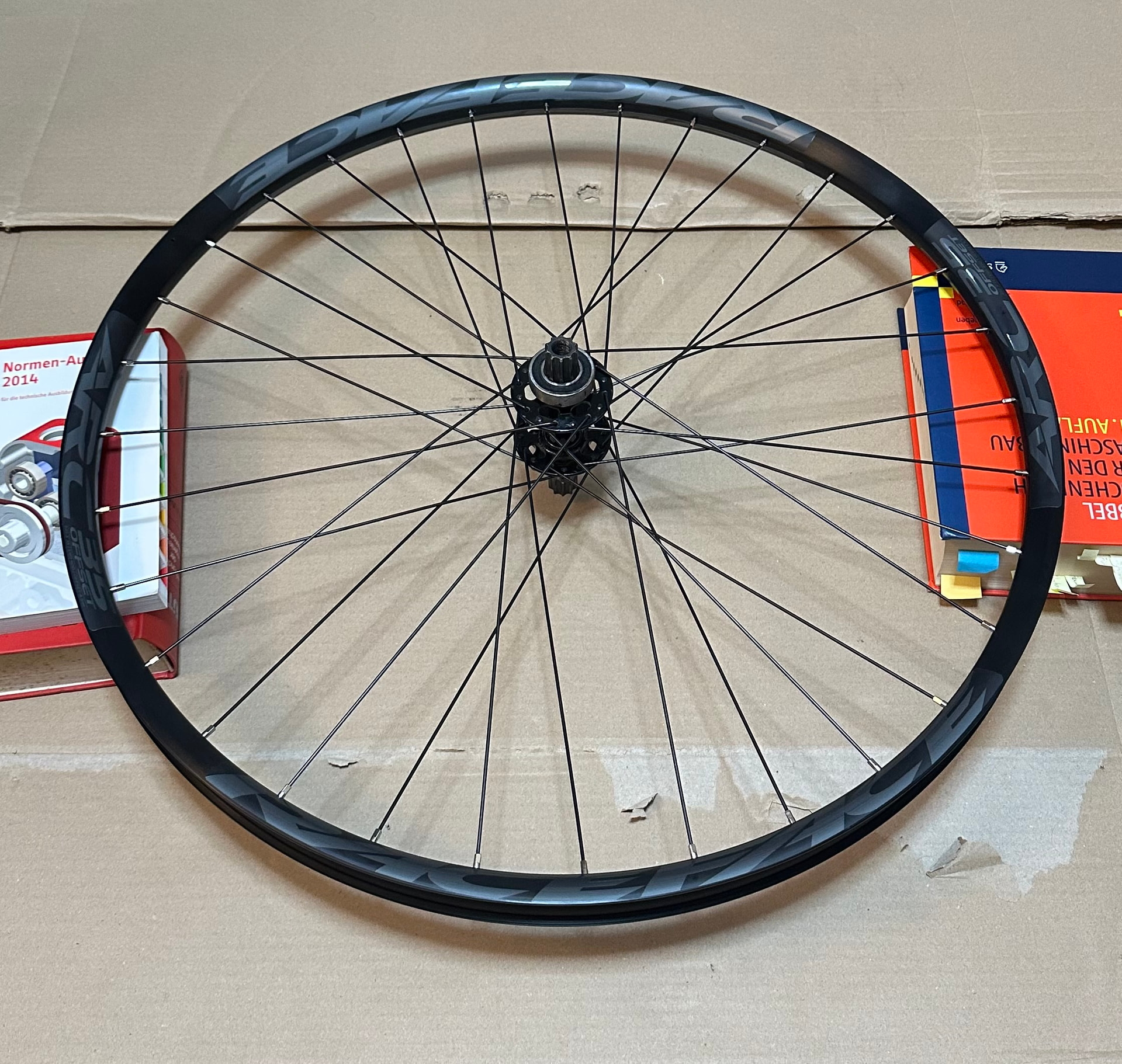

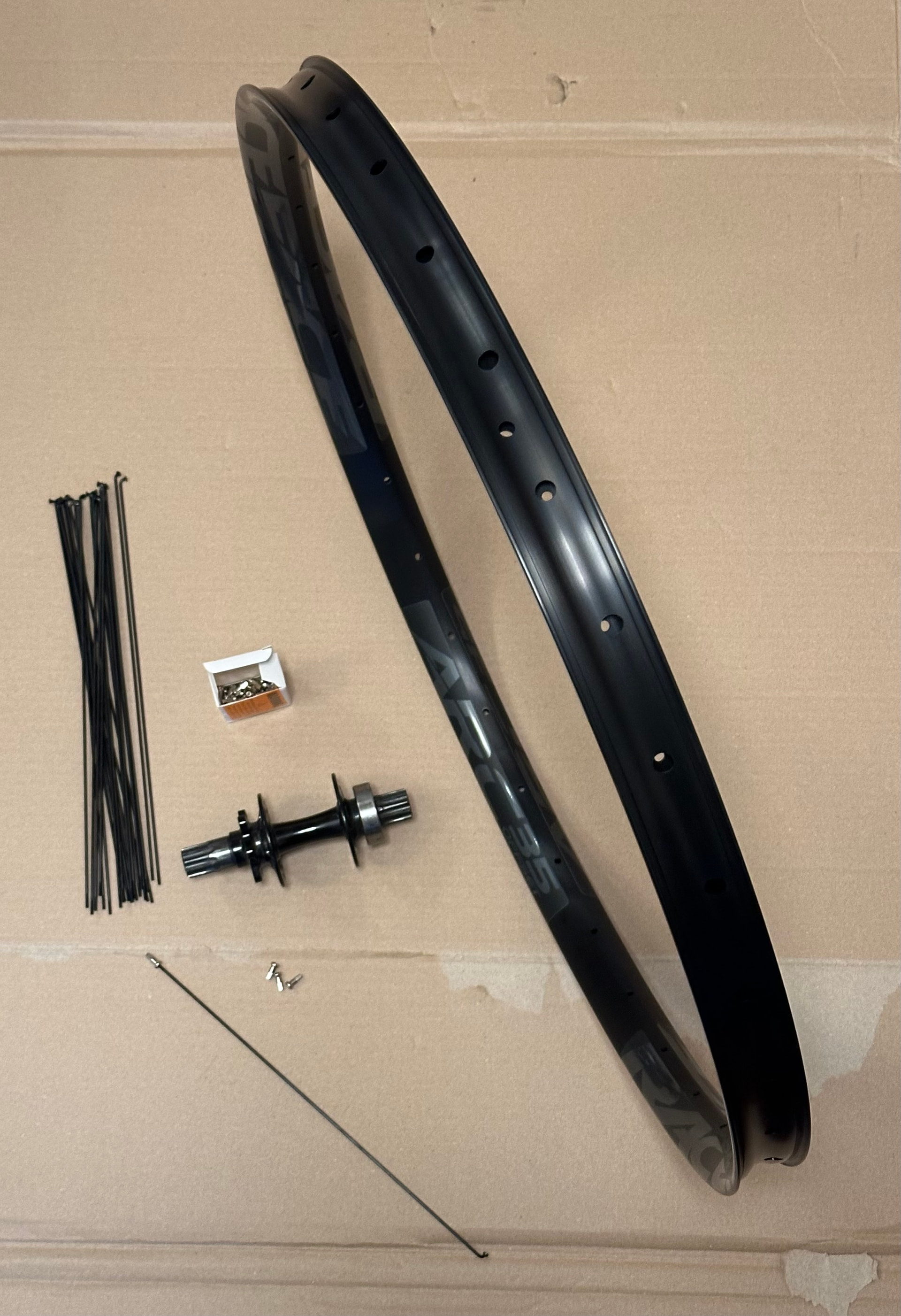

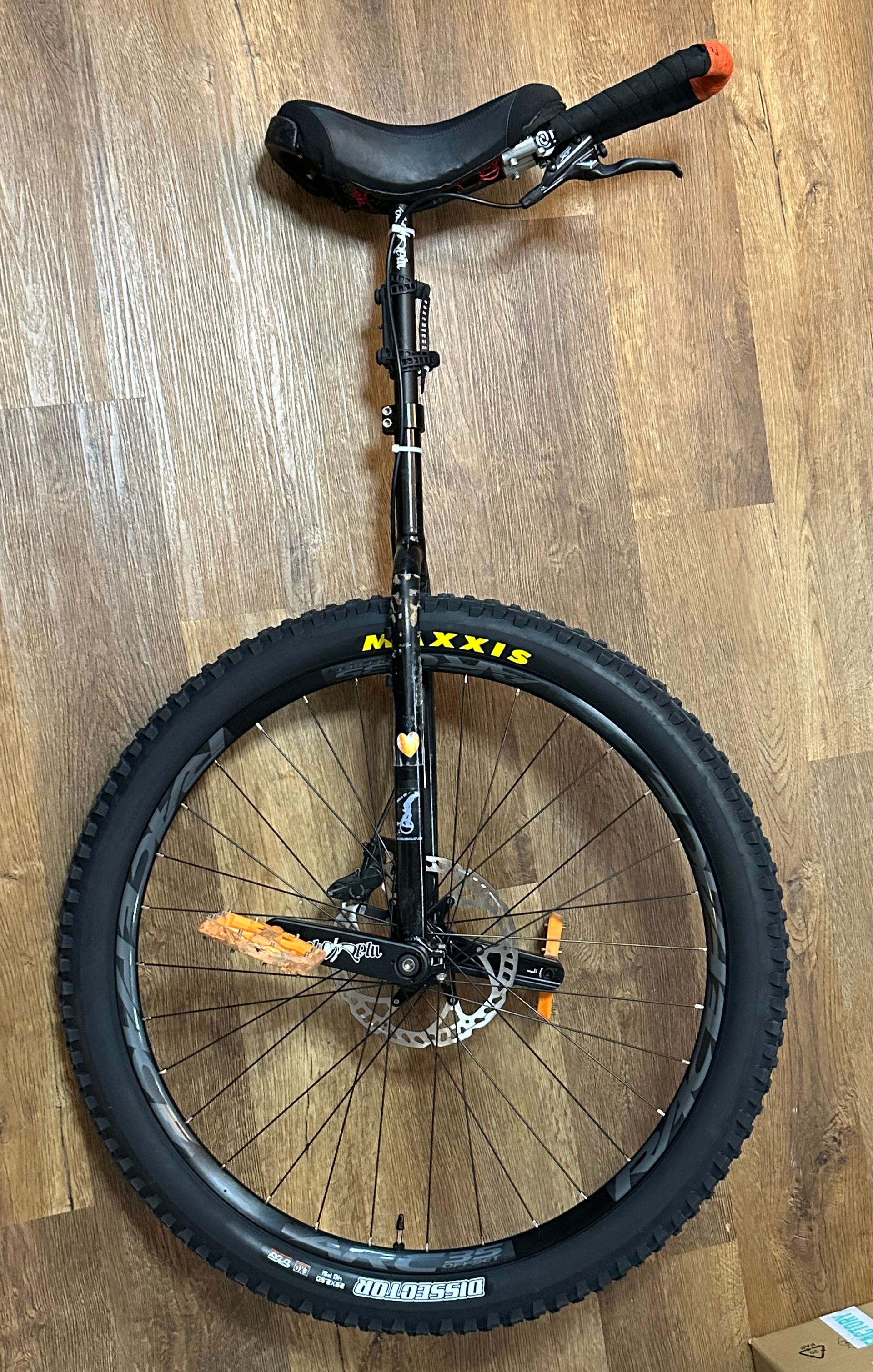

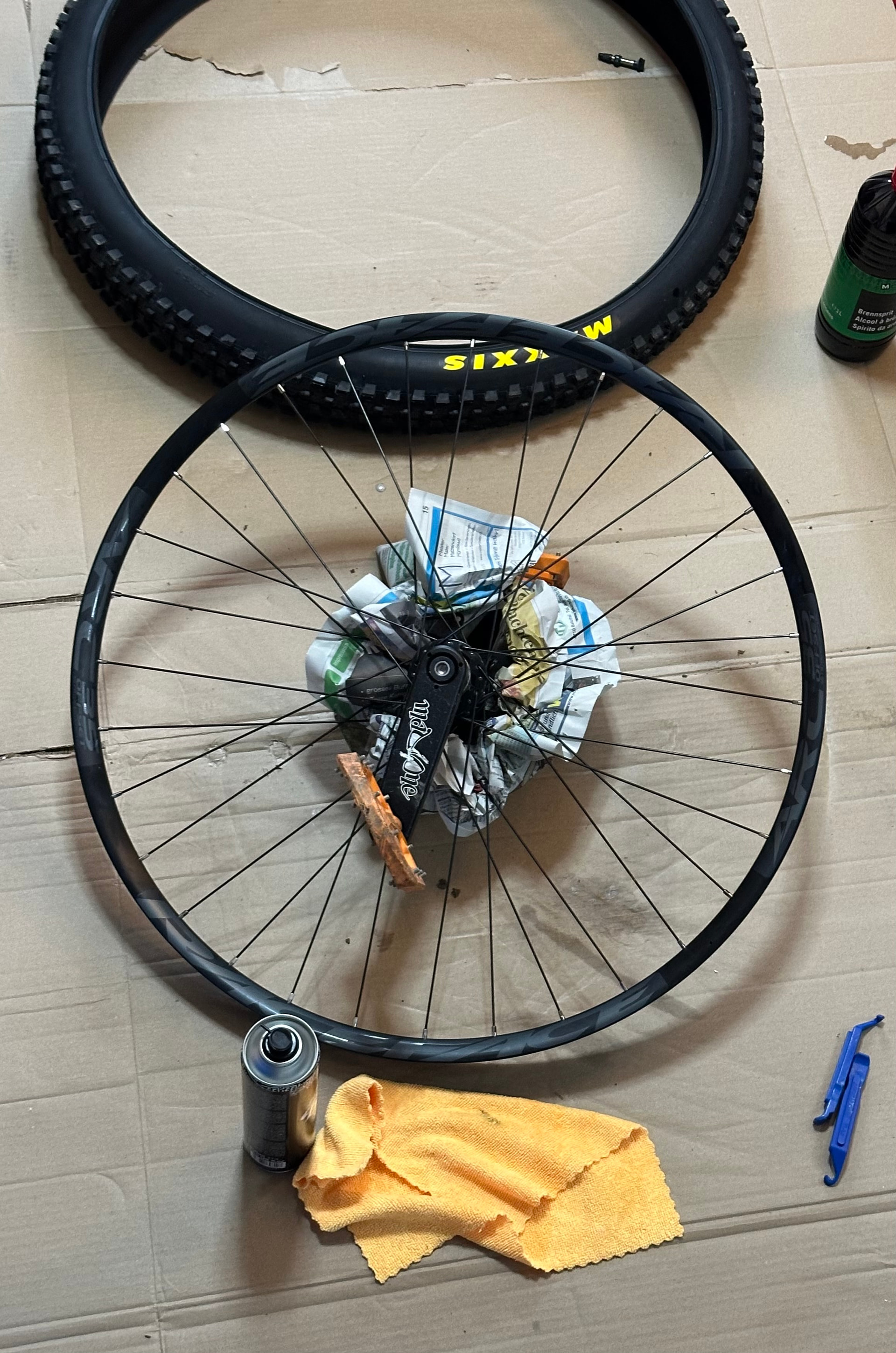

My current project is lacing up a wheel for a spare 32-hole hub. Nothing fancy or innovative, just curious how this offset rim made for two-wheeled mountain unicycles performs.
After meticulously dishing and truing, I noticed the valve stem on this extra-light TPU tube was too wide for the valve hole in the rim. One thing led to another and I ended up going tubeless for the first time instead of drilling into the brand-new rim.
The first try was fun, but didn’t quite last. It rode great on my home trail, then slowly lost air and wasn’t rideable the next day. I pulled everything apart, scrubbed and properly re-taped the rim and added fresh sealant (no longer the old, grainy stuff I had lying around). So now I’m hoping it’s still holding air tomorrow for the next test ride. :crossed_fingers:

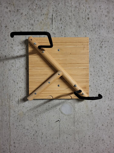

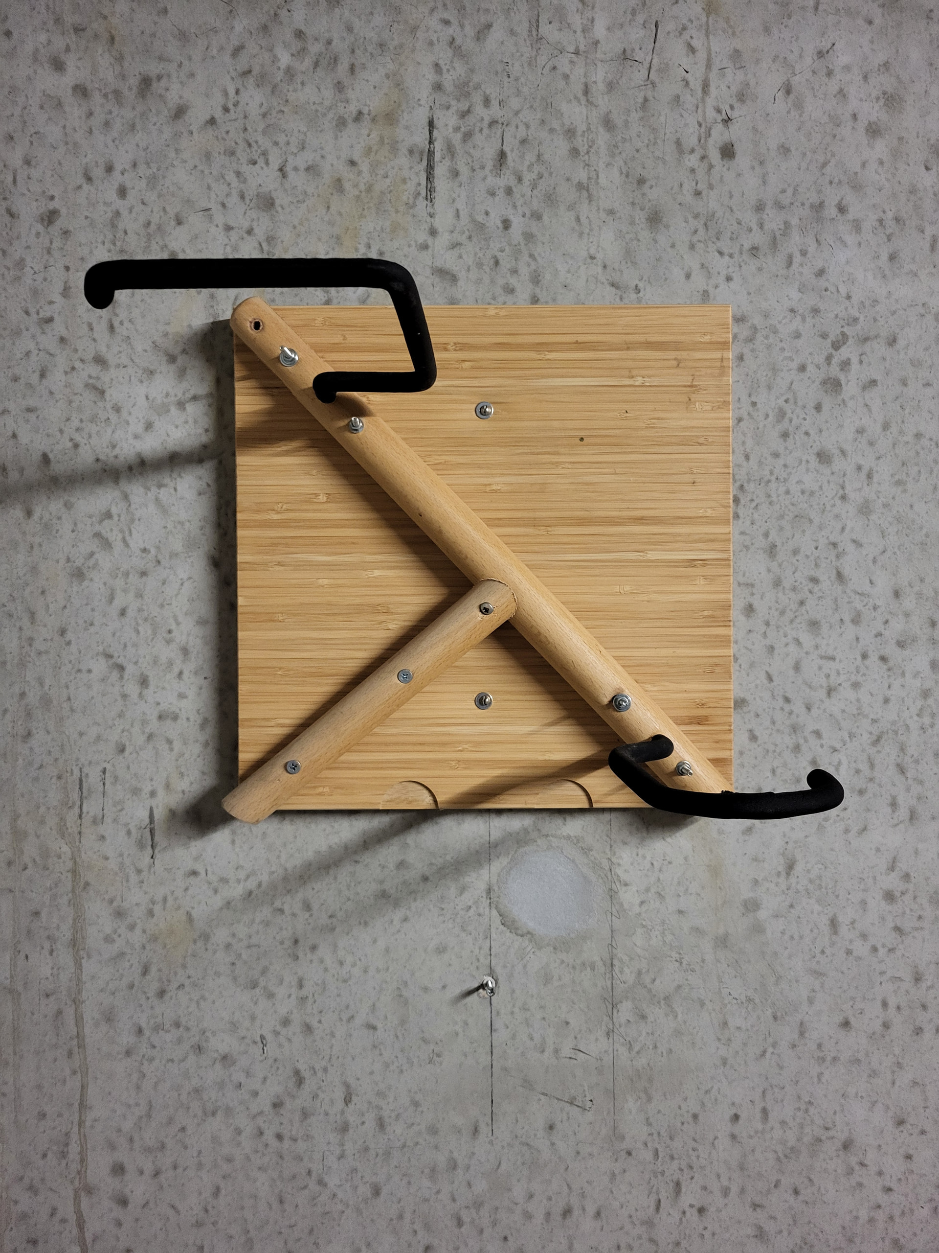

Nothing very fancy but the time has finally come to unpack and they needed a place to hangout (my unis a very literal :upside_down_face:) :
Apart from the hooks I already had, 100% of the hardware and raw material is salvaged.

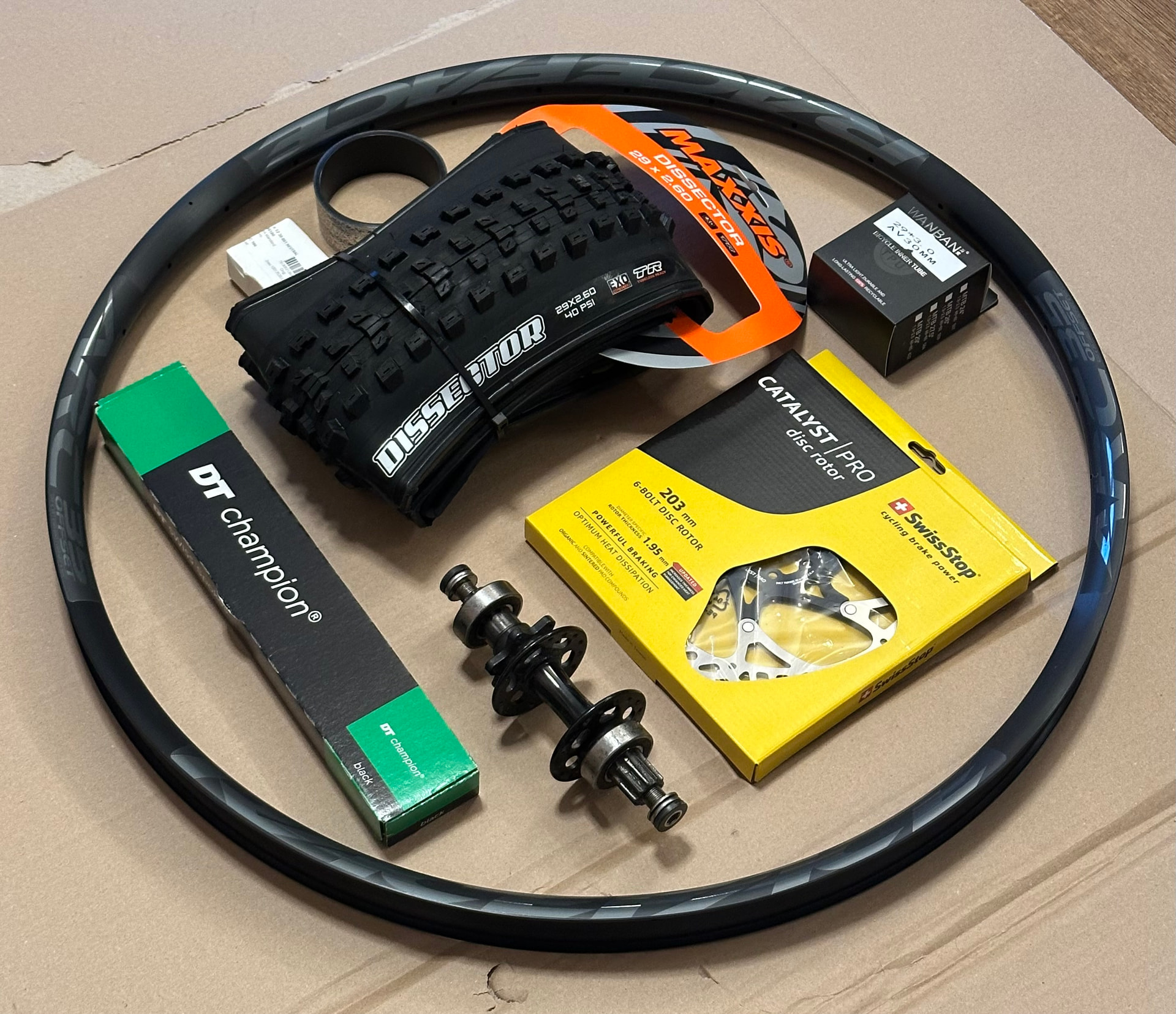

Sounds a stupid question but have you put the offset of the rim on the disc side of the hub.
Alot of people get this around the wrong way.
I arranged the hub and rim so that the rim is centred between the bearings, and the spoke holes of the rim sit approximately midway between the hub flanges. Because of that geometry, I was able to use equal-length spokes on both sides. With this setup, the spoke angle relative to the wheel axis is very similar on each side. I chose the offset deliberately. It’s offset away from the disc side, and in my opinion, this is the right way round for achieving equal spoke length and comparable tension on both sides.
How’d the new wheel work out? I’ve had mixed luck with aluminum bicycle rims. They can be a bit soft, flexy, and whippy… But not all of them. And while they are usually tubeless ready, that doesn’t mean they won’t burp under the lateral loads of muni…
I went with 2 mm spokes, which definitely helps keep things stiff, and up to now I haven’t ridden anything much bigger than stair-sized drops. Within that range the wheel has been behaving well with no noticeable flex, great handling, and nothing suggesting the rim is being overworked.
I’ve been using Tubeless since 2014 on all my Munis and I will not look back. It takes a couple days to really seal, but once it’s done, it’s done! I’ve had a couple burps over the years and 2 slashed tires, but those were very light XC tires from when I used to care too much about weight. I live in a very rocky area, where rocks are mostly sharp and square, flats are no secret to me haha.

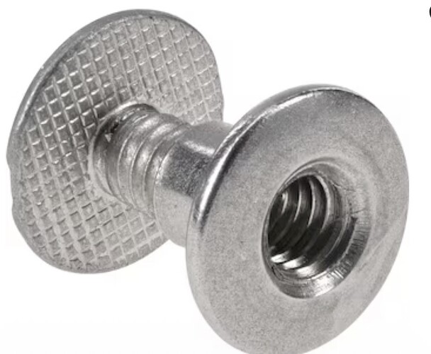

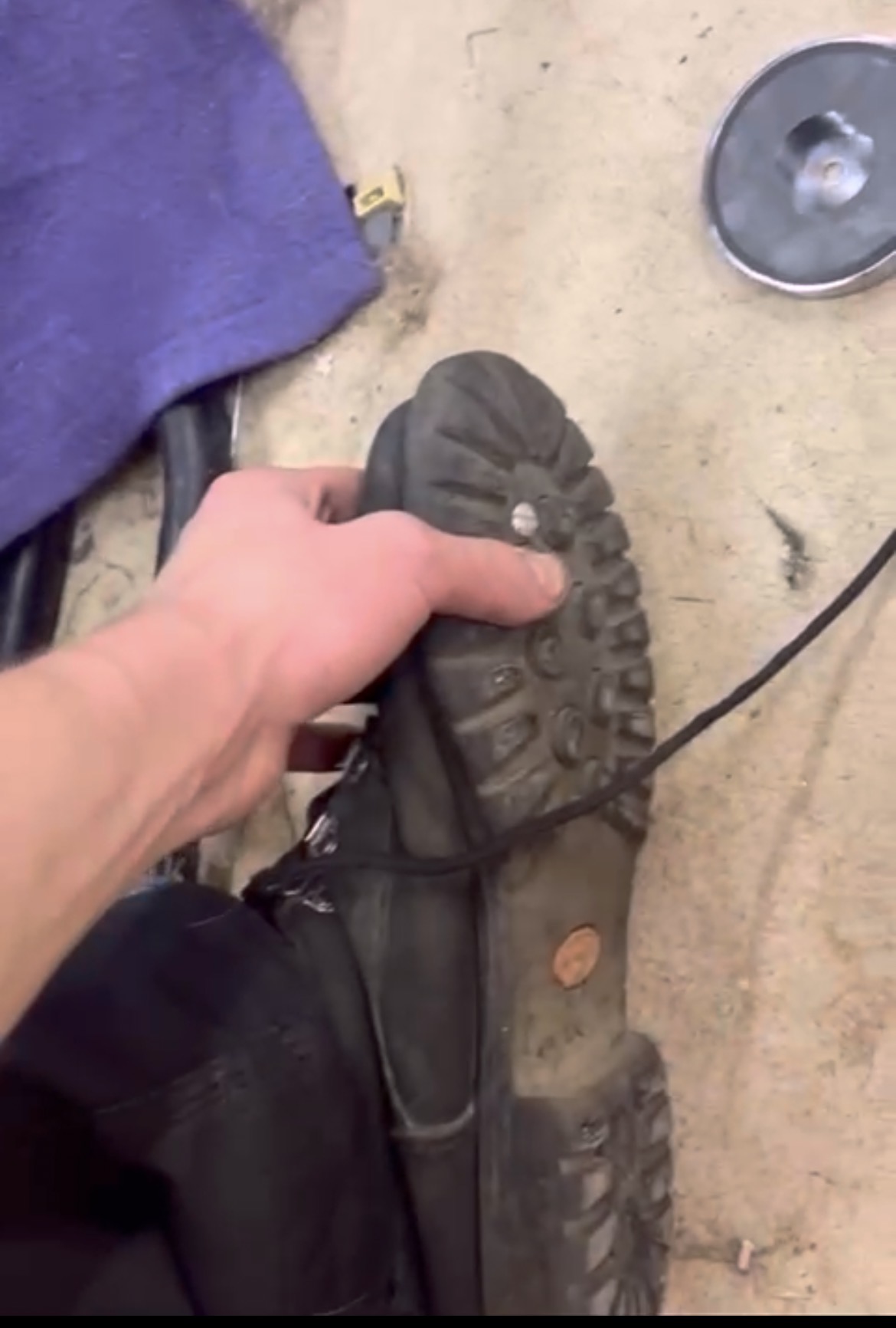

I want my rear foot to be strapped in, but my front foot needs to be able to bail in an emergency but I’d also like it to stay on the board when going over chunks. My solution is magnets, but I really like my work boots and I hear cleats aren’t good for walking, which dirt surfers do a lot of. So I’m trying to modify a regular pair of shoes to be magnetic. I’m going to bolt a magnet to the board/unicycle pedal and I’ve got these post binding bolts (the ones shown are not what I used but similar. I’ve drilled a hole in the shoe and inserted the nut from the inside and the screw on the outside, while walking I didn’t feel it but I have a sole insert just in case. The screw and nut are both made of aluminum so I will have to change the screw to steel, I also don’t hear the bolt hitting the ground when I walk. This was just a test but the final version will have the nut sealed in and water proofed

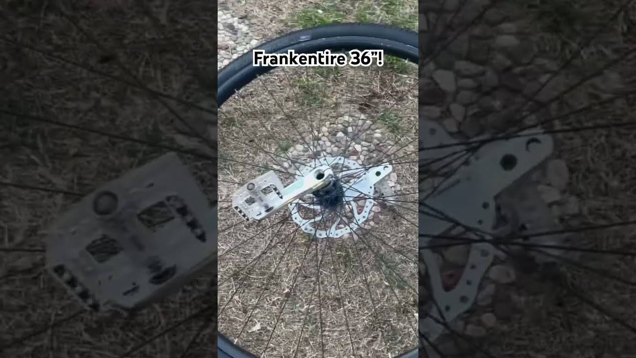

I decided to mount my unfinished Frankentire because I was in a bad mood but it didn’t blow up
